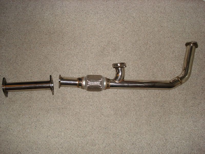

Postby danwags999 » Sat Aug 23, 2008 6:23 pm
PRICE DROP!
I bought this with the original group buy. I was waiting to assemble a full exhaust before I put this on. Now that I have a supercharger I went with the JPP exhaust so I no longer need this. Therefore it is Brand New. First $200 to danwags999@gmail.com takes it! I will not ship outside the US.

Just putting this on here for anyone who is going to get this, it will need to be fixed to fit onto ur car. The flex pipe needs to be moved closer to the flange. Thats the only thing it needs....
otherwise, this ypipe rocks!
Postby Midias » Sat Aug 23, 2008 8:28 pm
This pipe is totally worth the rework. When you get it done have the pipe after the flex moved in front of the flex and angled down slightly.

Like Dawgz and Midias said the flex pipe needs to be moved, but it's nothing your local exhaust shop couldn't handle. And from what I've read in the original group buy thread, pretty cheap too.

its a super cheap fix too, shouldnt be more than 20-30 bux at a decent shop...

Dawgz wrote:its a super cheap fix too, shouldnt be more than 20-30 bux at a decent shop...
To properly cut, extend, and reweld this, at a reputable shop, with a TIG welder (specifically for stainless steel), so it will not rust, expect to pay $100-150. TIG welds are not cheap, so make sure you take it to someone that knows what they're doing. Dawgz can tell you what one looks like when someone doesn't take it to the right shop to get fixed. It's not pretty.

TIG or MIG is fine as long as they use either 309 stainless filler or stainless wire. But for tig the have to use argon gas and mig has to be tri-mix gas. An experienced welded can do a wonderful job with both. I think I paid 100 to have mine done and I made sure they used 309L filler and polished the inside of the welds for flow.
