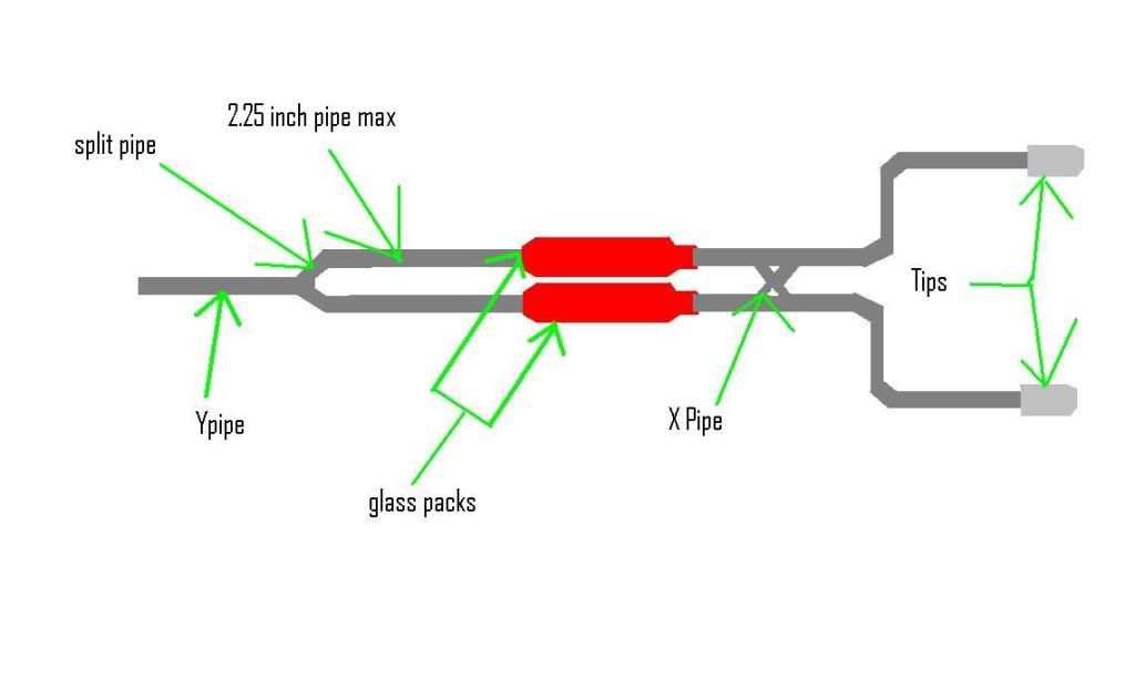

Are you running a single pipe back to a union? then T off or are you running dual pipes with a true H pipe?
Here is a Quick X pipe pict I made up for someone a long time ago
Postby Midias » Sun Sep 13, 2009 5:52 am
If you are running single pipe something like this megan system would be a good idea
Postby Midias » Sun Sep 13, 2009 6:07 am
Here is a x pipe and an H pipe with resonators next to each other
