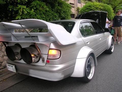

Postby crispone » Fri Feb 06, 2009 11:40 am
^^^ A combination of THOSE two mods will DEF make your 'lara scream!
...er... scream in HORROR, that is! :D
G/L with your modding!
Postby mazen222 » Fri Feb 06, 2009 11:48 am
^^^ haha... that first pic made me laugh... everyone at work is looking at me now
