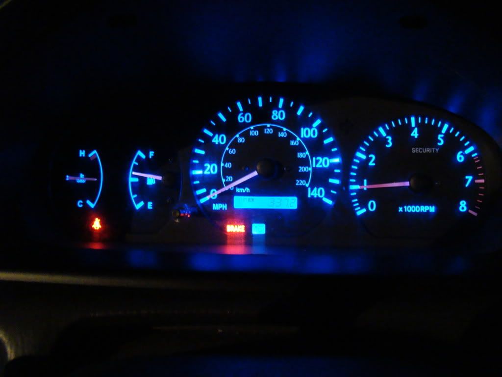

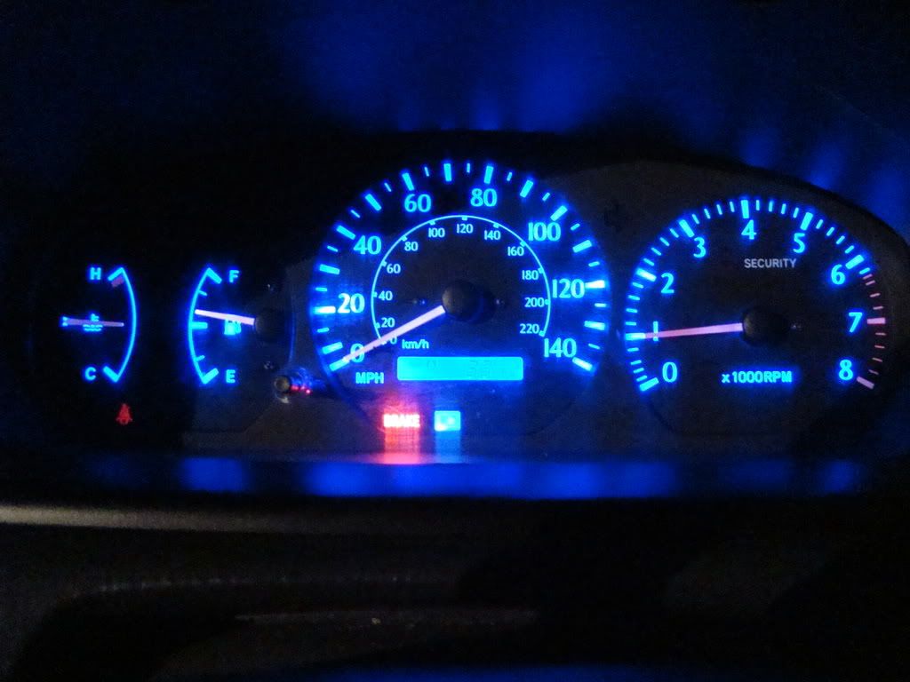

Postby Midias » Fri Jul 11, 2008 6:57 pm
OK here are pics sorry if they are a little blurry.

damn, looks pretty nice, whats the actual color when it comes near the redline mark, is it pink-ish or bright red?
Postby r0w » Sat Jul 12, 2008 12:29 am
looks like pinkish to me

Postby DaZanY4002 » Sat Jul 12, 2008 12:40 am
That looks really really nice vs our stock green shade.

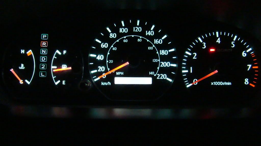

Postby AllShowNoGo » Sat Jul 12, 2008 6:31 am
Not to thread jack but this is what it looks like with the same bulbs in cool white. The blue i believe turns out a lot brighter then white due to the green tint over our gagues.

Postby Midias » Sat Jul 12, 2008 7:37 am
Dawgz wrote:damn, looks pretty nice, whats the actual color when it comes near the redline mark, is it pink-ish or bright red?
More of a dark purple I think I over exposed both shots and it came out pinkish.
Postby Dawgz » Sat Jul 12, 2008 9:26 am
AllShowNoGo wrote:Not to thread jack but this is what it looks like with the same bulbs in cool white. The blue i believe turns out a lot brighter then white due to the green tint over our gagues.
OMG
where did u get those bulbs.

Postby lilm » Sat Jul 12, 2008 12:12 pm
OMG
thats the color i got but i have a dim spot around 80 mph i think

Postby AllShowNoGo » Sat Jul 12, 2008 3:20 pm
bulbs are the same as midas but white.
superbrightleds...
