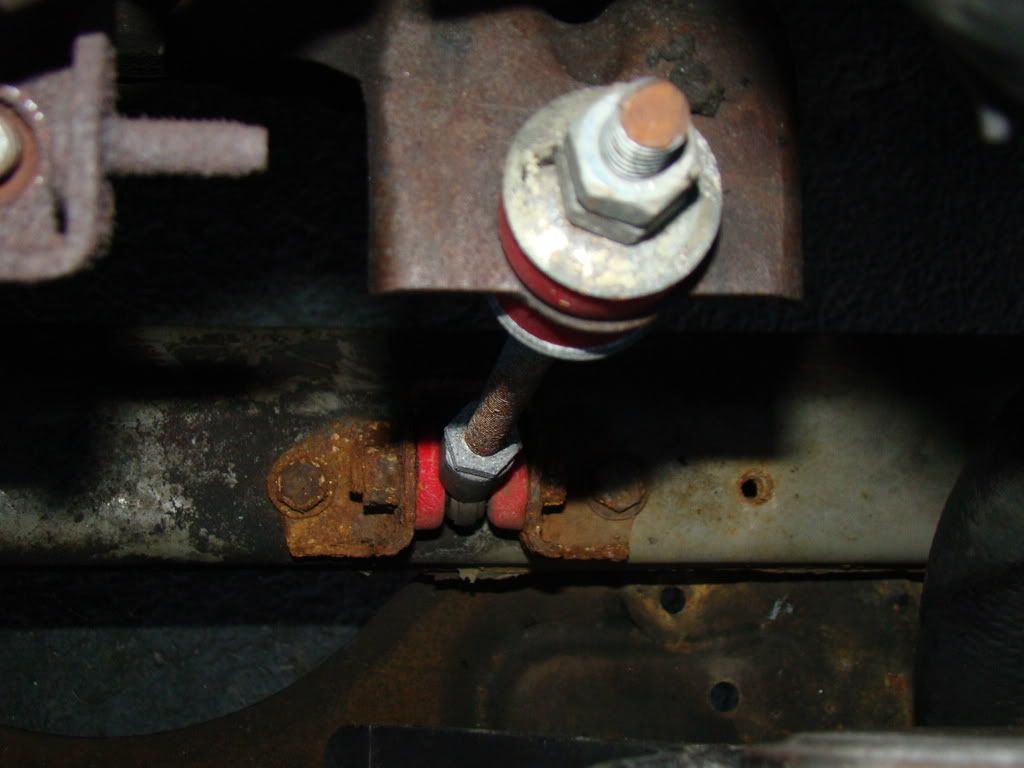

Midias wrote:
pwizzle wrote:I was about to send payment on this new batch of torque rods, but since this post came up, should I still purchase it? I don't drive my car very hard unless I'm bored on the highway. Would it also help if the dogbone bushing was upgraded?
I have not had a problem with my NA one yet but I also padded each side with a poly bushing I will take a pict tomorrow. I will also be checking the bracket and reinforcing it if needed then maybe I will start selling a few reinforced braces on an exchange basis.
Here it is and yea thats rust welcome to NY we have salt on our roads 8 months out of the year.
Postby pwizzle » Thu Sep 11, 2008 5:59 pm
Sweet, I already placed my order for the torque rod the other day. Where did you get the bushings for the lower part?
