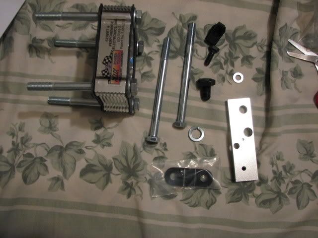

Got THESE In the mail, John (Sleeper) said to set it up like this??
But then how come I still have extra parts?
any one can take a pic of me of the finished product please?

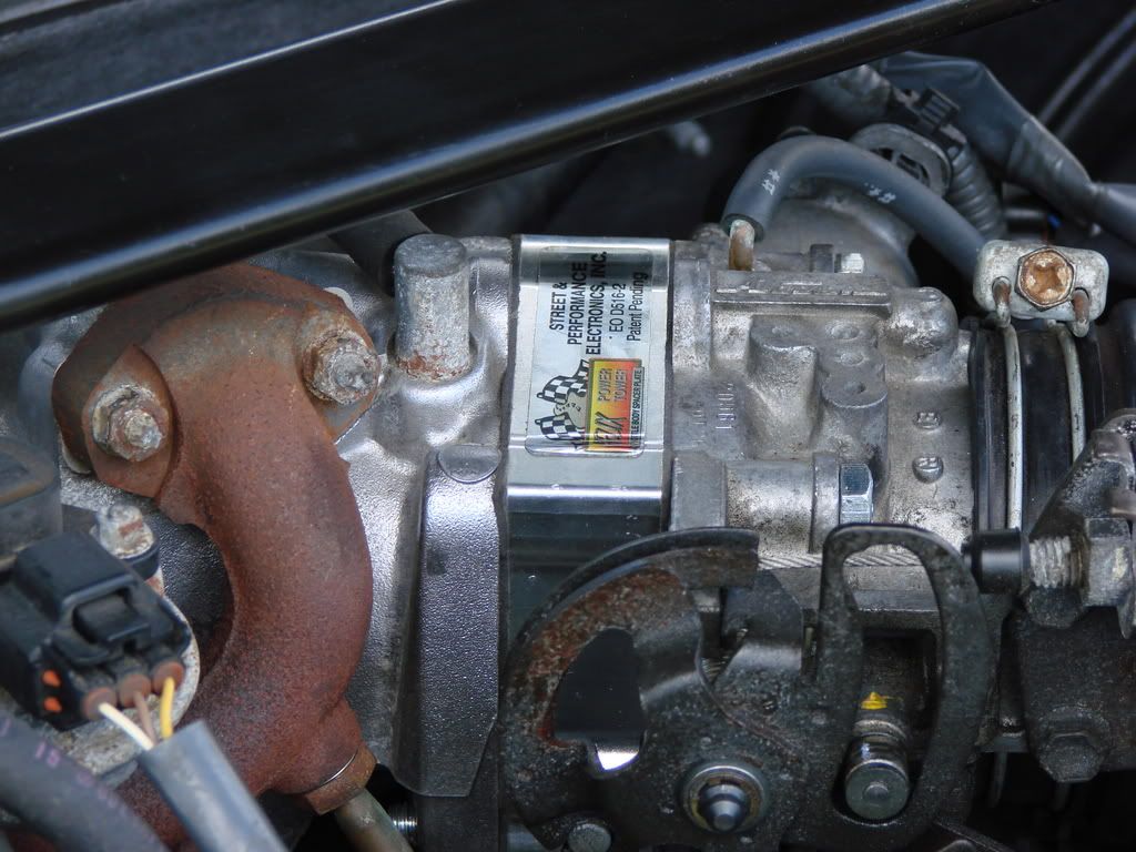

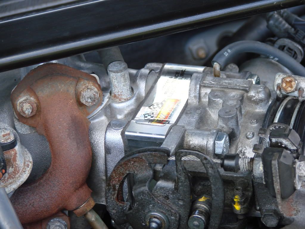

Postby Midias » Thu Jun 05, 2008 9:13 pm
The extra parts are for a tachoma all you need is the spacer bolts and gaskets here are a couple pics.
