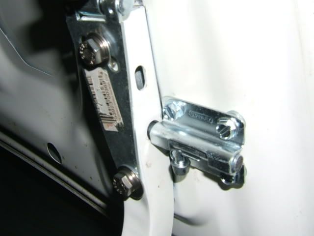

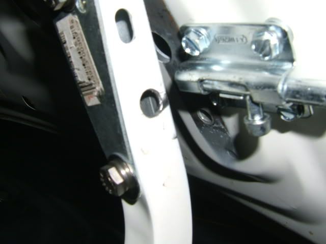

you must do this
if you dont add a dead bolt/ slide lock, your trunk will lift in the back near the windshield when you close it
other than that...this mod is easy to do and very inexpensive

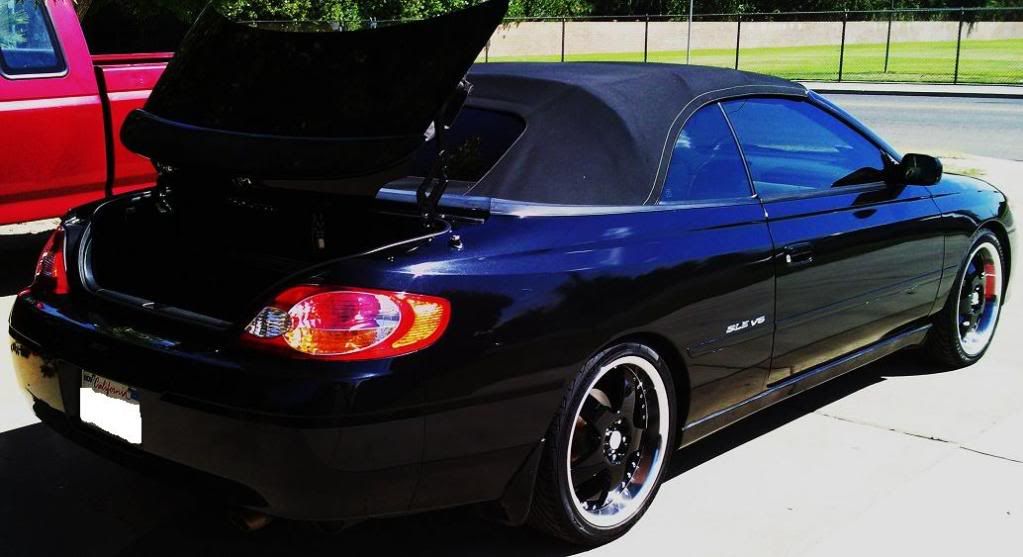

^^ Ok that pic is not a Flip-flop trunk.....it's A CONVERTIBLE. Seriously.

With this mod are you still able to open/close the trunk like normal if you have the dead bolt installed like kenny posted? Just pulling the bolt so it would flip down when wanted...
Postby kenny6683 » Sun Jan 10, 2010 9:46 pm
yeah with the dead bolt, the trunk will open like OEM, but mainly the point of the dead bolt is to prevent the back side of the trunk from lifting up when you close it
