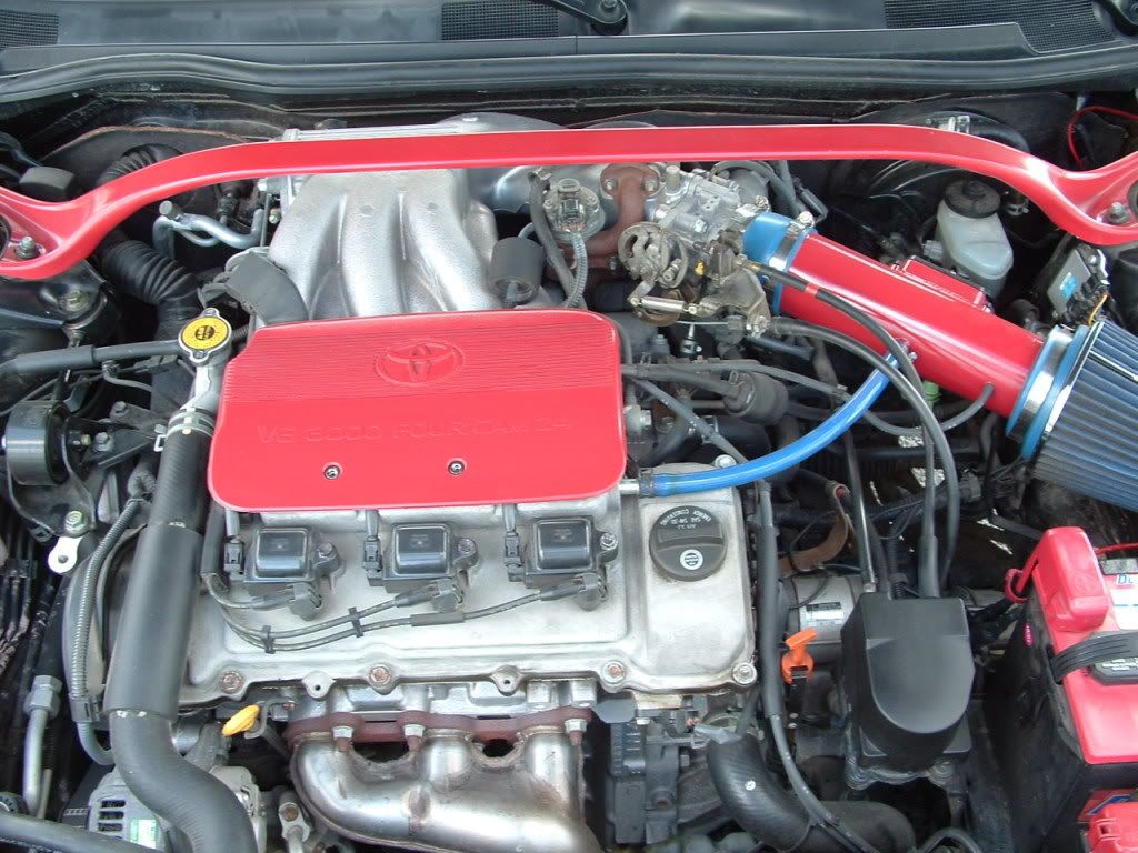

Postby Ilovemylara » Tue Mar 24, 2009 11:38 am
I have the same exact set up.. Only mine is red (was originally blue, didnt match so i painted it) Image
Overall it did make a slight performance gain, Butt dyno reads about 5-8 or so HP lol After the install My engine was running rich and I assumed it was because of the intake, but it turned out to be a bad MAF. I have since replaced the maf and it runs great. A sugestion though, if you buy this, the original bolts that hold the maf onto the stock intake will not fit. The shoulder is too wide, about 1/8 of an inch to be exact. I just used a cutoff wheel on my angle grinder and gently grinded it down a bit.
