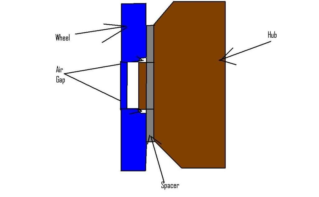

I've had both the 5mm and 10mm H&R kits. The 5 didn't have the hubcentric lip but the 10 does. The 5mm kit is tapered near the the hubcentric ring on the hub so it sticks out far enough to still make contact with the wheel. I never had any problems with either kit, and I've used them with factory and aftermarket wheels.
Postby Midias » Thu Mar 12, 2009 9:21 am
My rims have a small chamfer on the center of the hub and with the 5mm spacer not enough of the hub was sticking through to keep the rim centered. Here is a picture brown is the hub / rotor, silver is the spacer and blue is the rim.
