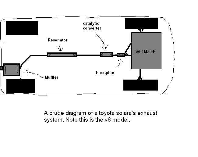

Postby Ilovemylara » Tue Mar 03, 2009 9:37 pm
This is my terribly drawn rendition of a v6 solaras exhaust system. try not to laugh lol
:P
Postby Skew » Tue Mar 03, 2009 9:50 pm
Excellent animation. Better demonstration than I could have mustered lol.

Postby gnegroni » Wed Mar 04, 2009 9:01 am
Skew wrote:Excellent animation. Better demonstration than I could have mustered lol.
Dude, I'm getting to love your drawings more and more every day! :rock:
Although I have a Gen2, it be best to leave that resonator in place. Our engines can get loud and ugly quick. Most people in this forum add aftermarket exhaust and headers, but they leave the resonator in place, or upgrade to a bigger one.
IMO, if your not going to upgrade to something releasing a few more HP or give a nice sound, don't remove the resonator.

Postby D-money » Wed Mar 04, 2009 11:06 am
thanks that drawing helps alot.
