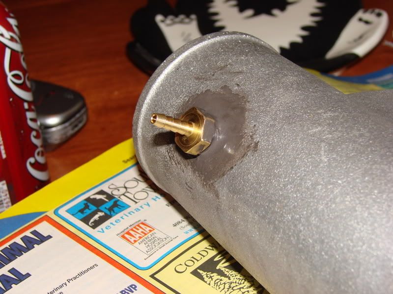

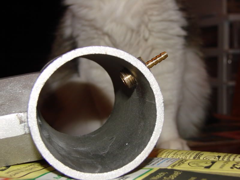

Also if you do decide to make a custom intake and I say give it a shot I use plumbing fittings and JB weld to make vacuum nipples like this.

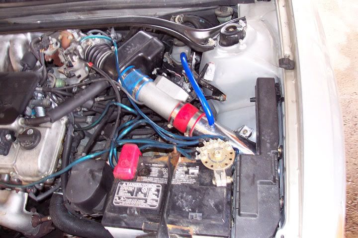

Odd I think I posted about it 1 or 2 days ago but any way that piece after the HKS adapter is one of RJ's CAI extensions for an Injen intake. But it was $120 for nothing more than a 90 degree bend and a mount. I would find an HKS adapter make sure it looks like mine and then get ANY cheap 2.75 CAI off ebay with a 90 degree bend and use the filer and pipe from that with the aid of a hacksaw. This is 3 inch a little more of a squease in but it should be PERFECT notice the long straight before a 90 bend.

depending on how hands-on you want to get....you could always pick up an extra airbox+MAF housing from a scrap yard, and then take off the MAF housing via hacksaw and JB weld it to the intake pipe.
when i fabricated mine, that's what i did (check out the pics i sent you previously ... you might be able to see the fit). the JB weld holds it on very well...as well as holds the hose attachments well too.

Makes sense. So you cut off the opening for the MAF and JB welded it to a 3" pipe? Just for clarification. In the pic I have I can sorta tell, but it really looks like one piece. Oh and did the pipe have the inlets for the 3 other hoses, the big one from near the spark plugs, and the other 2 that hook up to the intake box itself.
