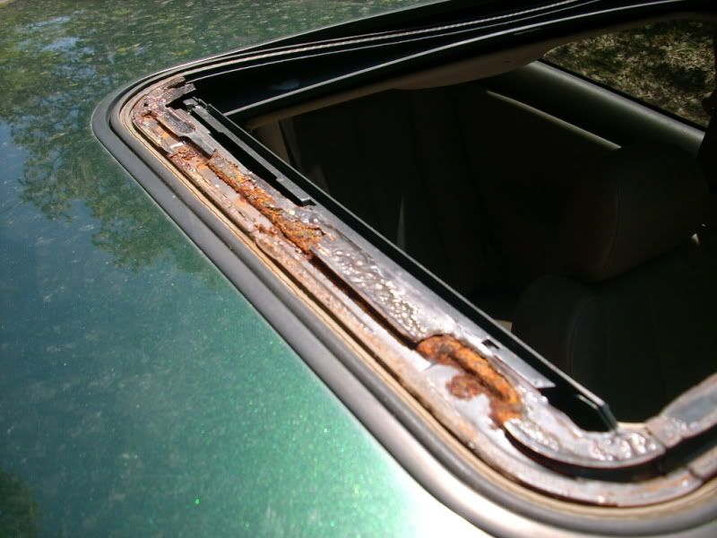

Well I now know that a Gen 1.5 sunroof will NOT fit a Gen 1!!!
I searched and searched the forum and found nothing about the 1.5 sunoof NOT fitting the Gen 1. The reason I'm telling you this is because mine blew off at a 110mph. So I called around to some salvage yards and found a 1.5 sunroof. I bought it for $175 and took it home. I get the headliner off (PITA) to find out that it bolts up differently. Im gona need the entire sunroof, not just the glass. When it blew off it took some of the trim with it so I cant just replace the glass. I dont know why the dam thing flew off but it did. I guess the seal was gettin old and it couldn't take the wind. My friend was playin with my camera so thats why I have a vid. The boom at the end is my sunroof flying off. Im glad that it didnt hit anyone!!! :D
Everyone with old sunroof seals should get theirs resealed if you have a lot of wind noise. The price of resealing a sunroof is nothing compared to a whole new sunroof. I let yall know how much more this is gonna cost me.:cry:
http://www.youtube.com/watch?v=lPmFzUMu0P8
Here is the aftermath:

Postby TLMNICK » Fri Apr 03, 2009 9:05 am
It blew off becuase the brackets are rusted to $hit. The gen1.5 roof should fit just fine...BUT generally, nobody ever replaces just the glass.
To me, that doesn't even look like a factory sunroof. Perhaps that is why the stock glass don't fit.

Postby ArizonaEagle07 » Fri Apr 03, 2009 9:23 am
It must have been closed, because doesn't the sunroof go inside the roof when opened? Technically if it tore off when opened he would be driving a new convertible cause it would have taken part of the roof with it.
The brackets are very rusted that's probably the first cause and the second is that a suction was being created at such a high speed it created a vacuum and ripped off the glass.

Postby TLMNICK » Fri Apr 03, 2009 9:29 am
If you look at the last pic.....the rubber moulding sits on TOP of the roof, rather than flush with it...only aftermarket sunroofs are like that because they are universal. For the most part, cheaper aftermarket sunroofs open to the outside (similar to GM cars).

Postby aleki2424 » Fri Apr 03, 2009 3:00 pm
TLMNICK wrote:If you look at the last pic.....the rubber moulding sits on TOP of the roof, rather than flush with it...only aftermarket sunroofs are like that because they are universal. For the most part, cheaper aftermarket sunroofs open to the outside (similar to GM cars).
^^I second that. Your sunroof looks like its an after market unit. It has a different design. The actuator that kinda retracts a little as the glass slides is not even visible, from the photos you have. universal sunroofs also have ALOT of leakage problems , something that is also noticeable from all the rust that you have. None the less, it should NEVER fall off under any circumstances. Your best bet would be to replace everything, including the mounts and seals. simply replacing the glass would not do, at least for the long term.
