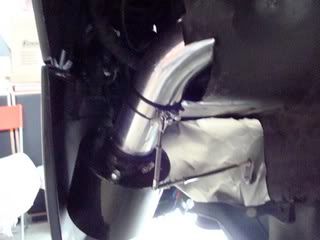

Postby Astro » Mon Jul 30, 2007 3:24 pm
I believe the only way to run it is with a SRI with an extension. Either Injen, CPE, or a homemade one it wouldn't matter. I don't know how you'll be able to hook it up with the stock box.
I got rid of my UPFD extension and now I'm using a 3" 45 degree bent pipe, which I didn't even have to modify. This is much better IMO, and it doesn't cost as much.
