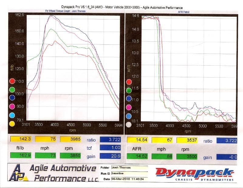

FIRST (BASE) RUN: March 5th, 2010
Set up: N/A Camry v6
Miles: 157,000
Modifications: Injen SRI (short ram intake) w/ K&N cone filter
Reaction: Terrible!! Running very rich. As you can see, for the first three runs, each run was leaner than the previous run resulting in dramatic increases in performance. What could it be? O2 Sensors need replacing? Dirty MAF? stock MAF too small for my intake? Spark plugs? Hmm...
Notes: I'll be replacing my spark plugs (with NGK) when I install my S/C, and after which I'll be using an SAFC II to tune the AFR. I would like to change my O2 sensors as well, but the dealership prices were too high and I haven't looked into how much they cost elsewhere.

Hmmm... Interesting for sure. Your car is running pretty badly for a stock baseline. Some pretty bad numbers actually- but as you said, could be a number of reasons why, but the afr makes it pretty obvious.

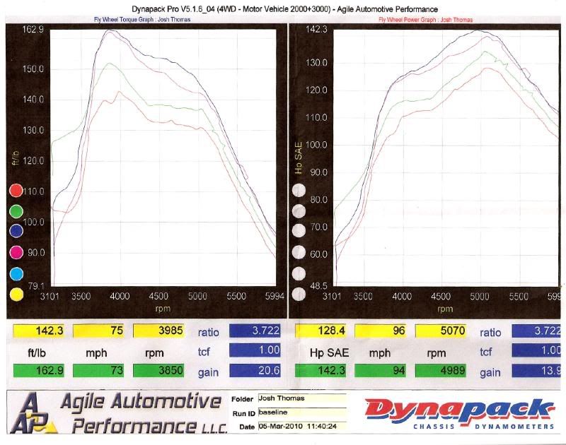

Postby 99BlackSandv6 » Sat Mar 06, 2010 2:49 am
Ouch! :o
I got 153 on my dyno run last spring, and that was with a home made restrictor in my ebay intake. No other mods. Also made over 171lb/ft of torque.

Eye8Pussies wrote:Hmmm... Interesting for sure. Your car is running pretty badly for a stock baseline. Some pretty bad numbers actually- but as you said, could be a number of reasons why, but the afr makes it pretty obvious.
And 75 for 3 runs isn't great, but 150 for a tune is pretty decent for sure!
I think the reason they charge $75 is because it's a hub-centric (i think thats the term) dyno, where they attach the machine to the hub. I guess that takes more work than the more common roller set up? Having to remove the wheels and all. *shrug*
Yeah I really don't know why I'm running so rich. I think this issue with running rich is a relatively new occurrence. A couple weeks ago randomly one day I was getting a VERY strong gaseous smell in the cabin blowing in from the engine bay. It was incredibly noxious. I left the car idling for about 10 minutes with the a/c on and when I opened up the door it was like sticking my nose into a gas tank.
The smell never returned after that day. I SeaFoam'ed later that day and found a really bad front manifold leak (which I posted a video of here on SG)... but the smell hasn't returned, certainly not anywhere near that bad.
Maybe a spark plug isn't firing... but the engine feels fine. I'll be replacing my sparks in a couple weeks when I put the S/C on. The exhaust Gabe is helping me put on this weekend may balance it out some.
We shall see...

Postby Eye8Pussies » Sat Mar 06, 2010 9:22 am
lol...forgot about that bad front manifold leak...you basically just found the reason for your rich afr
the leak looked pretty bad in the video, and long story short, you are losing enough exhaust through that leak to make your o2 sensor think that you are running lean- hence, the ecu will then add fuel (at least to your rear- radiator side- bank). A leak of that proportion will affect both your short and long term fuel trims, and can even result in a change in the preset open-loop settings.

Postby SoSleek » Sat Mar 06, 2010 1:15 pm
So you gained nearly 14 HP and 20 ft/lb TQ out of just an intake? WOW!!!! I mean like mentioned...the stock motor should be pushin a lil more itself...but that type of gain looks great! I think it's awesome you will be dynoing EACH mod! PROPS! never seen that done before!

Postby SirThomas8 » Sat Mar 06, 2010 9:59 pm
Eye8Pussies wrote:lol...forgot about that bad front manifold leak...you basically just found the reason for your rich afr
huh... good thinking! Well I'm getting my headers on tomorrow so if that's the source of the problem then that should fix it. And if that is the case not only will I be seeing a gain from the headers, but also a gain from the leak being fixed.

Postby EEngineer » Mon Mar 08, 2010 7:35 am
damn, your 1MZ got some issues cuz it definitely should be making more power than my 3VZ...or at least horsepower
my last dyno, while i still had an exhaust leak, i was running at
163.7 whp
168.5 ftlb
and i was using the same hub dyno as well.
they do say though, hub dyno will turn out lower numbers but it's always more consistent and accurate
