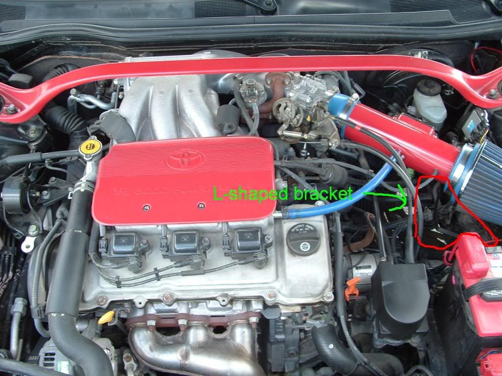

Ok guys ever since i got my sri it came with two small metal brackets to hold it up and not let it hang, but my problem is that i cant find the correct place to mount the two brackets.
Does anyone have any pics of their intake and how they mounted the brackets from the car to the intake?
I would appreciate any help given

Postby Ilovemylara » Wed Jun 24, 2009 7:31 pm
My is held up by a bracket that i custom made. Its a flat piece of metal bent into an L shape, with a hole drilled in the bottem, where i screwed it into the existing holes where the factory air box was held in. at the top, its bent parallel to the sri, so it just slides underneath the filter, and tightens down as i tighten the filter clamp. It works really great and is very easy to make.
All you need is a piece of metal, a vice, and a drill.

Postby Ilovemylara » Wed Jun 24, 2009 8:08 pm
heres a pic of how mine is held in place. the L bracket is "circled" in red.
Postby ToyoSolV6 » Wed Jun 24, 2009 8:14 pm
Ilovemylara wrote:heres a pic of how mine is held in place. the L bracket is "circled" in red.
hmmm looks pretty easy thanks man :)

Postby RandySolara » Fri Jun 26, 2009 9:26 pm
Ur intake look like the one i bought, the different is i drilled a small hole for the small hose, but after driving for 4-5 miles, i got the CHECK ENGINE light came on. Midias said cause my intake pipe is 3inch, the Injen and original required 2.75inch, how did u made ur intake work on ur car ? did u also get the CHECK ENGINE light on ?
I drilled the small hole near the MAF sensor, ur small hole is near the air-filter,,,,,,
