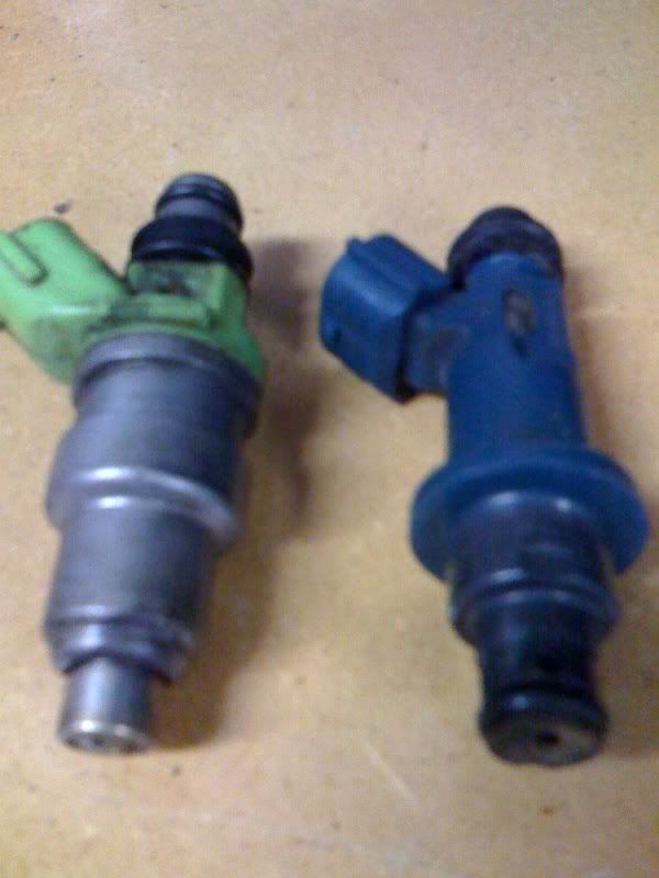

If any is using those injectors or something similar please let me know which O-rings you used for the area that sits in the lower intake manifold. on the lime-tops there isn't a groove where the O-ring would stay put. This is only a temporary setup. Also plan to just cap off the air-assist on the lower intake manifold.

see how the stock injector has an O-ring and a groove to hold the oring there on the bottom one. on the lime tops its straight down. no groove to keep the O-ring in place.

btw.. the injector (lime top) is about 2-3mm shorter than the stock injectors so all i need to do is shave down the fuel rail plastic spacer. only issue I need to figure out is that O-ring one and I can start breaking in the motor without worrying too much about running lean.

so similar to the 2jz redtops, you may not need the lower o-ring at all as long as you can get a grommet on it and the end of the injector doesn't extend too far
Postby hybrid2 » Tue Nov 18, 2008 8:19 pm
so anyways.. i went to my toyota parts guy and luckily they had the grommet in stock. I purchased a set and got home to test fit it. it sits a tiny bit taller with the grommet on so all I did was go through my assortment of washers till I found the one that would fit right and give the grommet on the bottom a tiny squish so that it's sealed. not too tight and not too loose.

sorry to bring back an old thread but just means that another related problem came back.. the injector grommet wasn't holding up. The lower grommet that I used last time deformed.. on the air assist port where the injector sits. the grommet seemed like it was getting sucked into the air assist air channel. The air assist ports are capped off. I guess my next step is to seal up those air assist ports so I it'll be just a circle and get new lower injector grommets.

Sorry I'm late but the lime green injectors are a direct bolt on, just go to kragens and buy the supra injector seal kit, I had these on miltons 1mz/3mz hybrid motor and now those are on franks 300plus hp solara(jetbtkng)
If you have any question hit me. Top engine builder
forthewin. Red and lime top fit the same.
