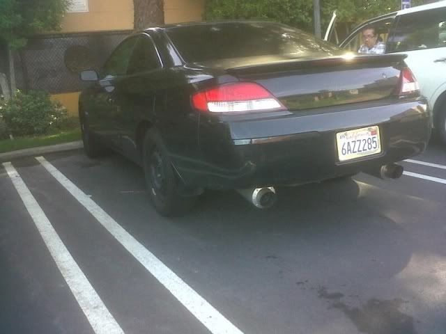

Postby yaddadaimsayin » Tue Nov 09, 2010 12:00 pm
saw this in Union City the other day. Those steelies look abnormally large, and the car has 20" decals on both sides of it. Rollin on dub steelies?? :crazyeyes:
Re: Dual exhaust props
Postby stringbean » Tue Nov 09, 2010 12:21 pm
that is gross looking, someone should hit the guy for ruining a perfect car!

Postby S.Z.-Alpha » Tue Nov 09, 2010 6:12 pm
Talk about fire in the hole O_o Those things look like they'll shoot something XD
