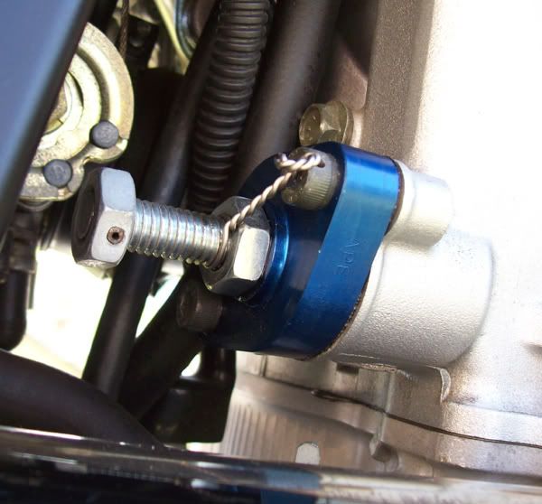

Wow man, that sucks. The only thing I can recommend is possibly safety wiring them. I used to build a lot of motorcycles for the race track and safety wiried everything on them. I still safety wire all of my street bikes as well. The only thing with safety wire is that it won't hold up to stress, it will just prevent a bolt from back out. Some examples of items on a bike to wire up are any fluid holding bolt like a drain plug, brake caliper bolts, brake pad pins, hose clamps, radiator cap, and axle nuts.
If you want anymore info on it, let me know. I've gotten pretty good at wiring things up. Here are a couple pics to give you an idea of what I am talking about. This is one of my bikes.
This is my manual cam chain tensioner that is safety wired so it won't back out

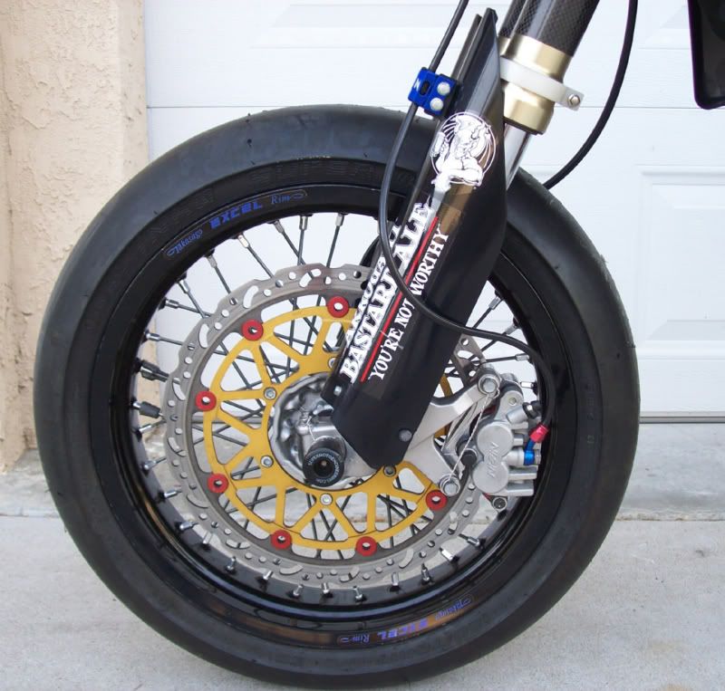

Here is a pic of the front wheel. If you look closely, you can see the safety wire running between the caliper bolts and from the axle to the pinch bolt.
