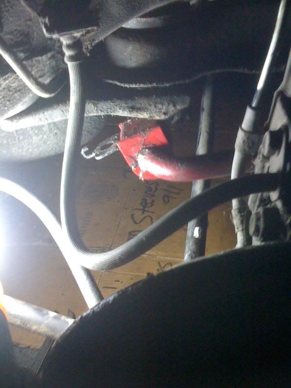

Let me start by saying that I understand and accept that I'm a complete noob with regards to automotive work but I'm determined to learn no matter what it takes. Your words of wisdom are welcome.
The Adventures of my TRD RSB Installation:
Finally got the stock bar off, had to saw 2 sway link bolts off because of the damn hex bolts and Canadian winters. Finally got the TRD bar in position, was a b*tch to finally get the bushings and brand new end-links threaded.
Guess what happens when I tighten the bushing bolts?
SNAP!!!!!! 1 on each side!

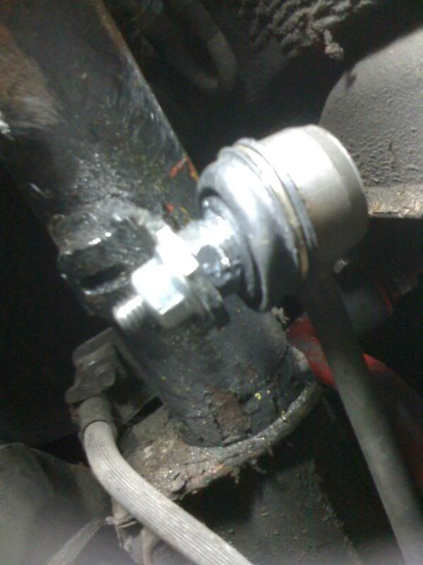

Guess what happens when I used needle-nose vice grips to hold the new TRW links, rather than use a thin crescent wrench?
Oh shttttt I moved the boot, are they wrecked?
How f***ed am I?

Now about the boot on the end-link... not a clue how to get it back into place without ripping the rubber...
