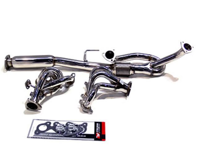

On e bay... don't see any provision for a CAT :-? Also, what about O2 sensor port?

No CARB EO number and not legal even if you add a legal cat you will fail a visual inspection.

^ if you had a california cat welded on that was good enough to pass the tail pipe sniffer.

the senser port is there.you will have to do what midias said and then find the visually impaired inspector.frank and i are having a stock cat welded to some flanges and then some flanges welded to the reseinator and flanges welded to the pipe so we can bolt on the cat for smog testing and then remove it.

you dont need to weld the cat on, just have a muffler shop cut the front resonator off and put flanges on both the cat and resanator, the you can run cat free, or put the cat on when you smog, yhats what i have on my solara's................... :drinking:

I already have a custom Y pipe...very good one (SS) done custom for me by *CATTMAN* (the Maxima Guru) 8 years ago. This has my Cat already welded on. I should be able to bolt up the OBX headers to this pipe...right? :D

Here is a pic of my custom Y pipe. Note how both banks come STRAIGHT BACK...as opposed to the OBX Y pipe, which is more convoluted.
Image[/img]
Here is OBX Y pipe in comparison
Stock Y pipe :(

so your pipe is basically a dump pipe as well....better than stock at least.
but equal length runners produce more torque in general. same with longer collectors.
but as to answer your question, no, your y-pipe will not bolt on to your headers....the design of the headers make them different lengths and dimensions than the stock headers from what I can tell when I installed mine

I'm not so sure about your take on the pipes though :roll: ....the twisted pipe restricts flow as opposed to a straight pipe. Anyway, I'll be doing a dyno at Church soon (without OBX) and it will be interesting to compare mine with Franks since we're both 5 speed SC...He had 6 lbs and OBX set up with cat back and PUMP/Injector upgrade with 285 HP (at time of dyno). I have 5.5lb and none of the other mods (stock headers and my Y pipe with cat back). Stay tuned!
