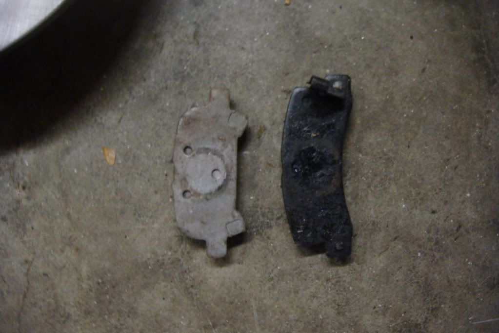

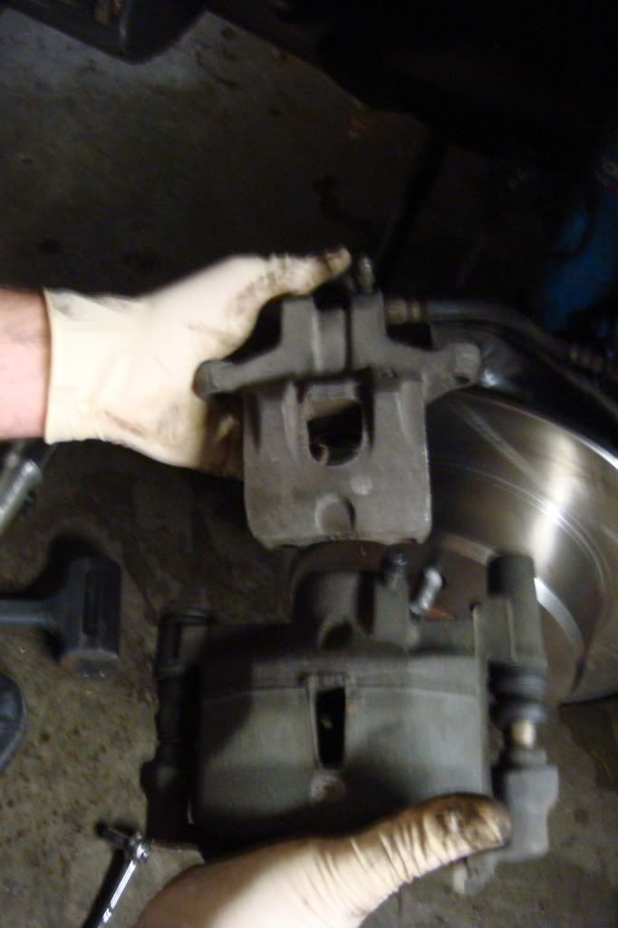

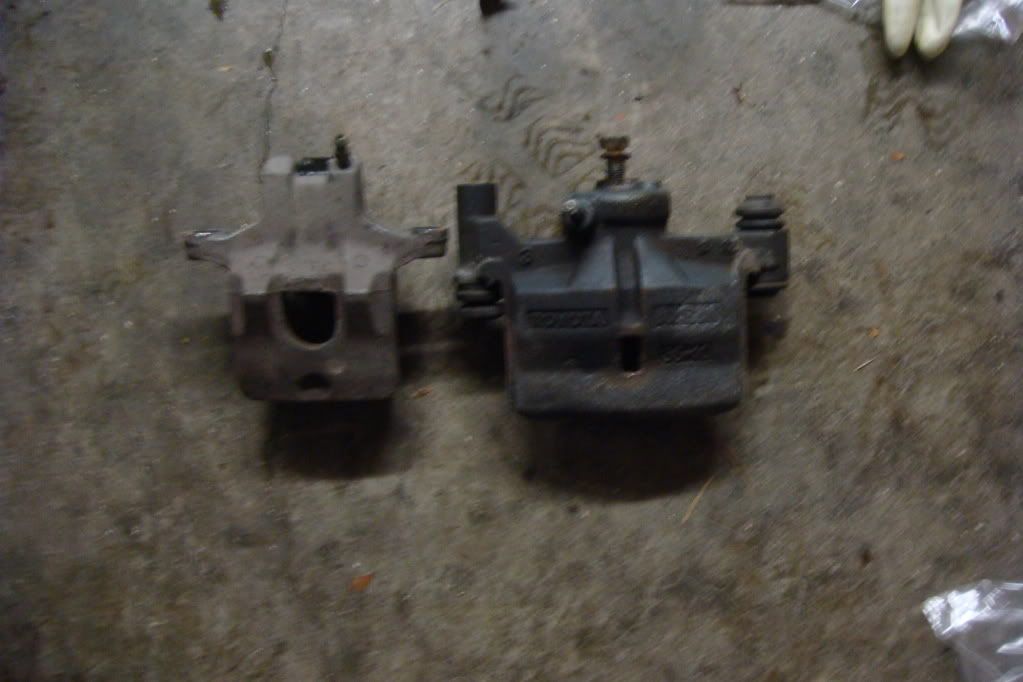

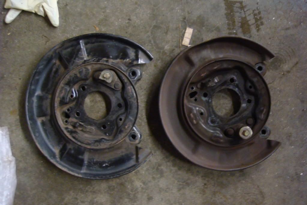

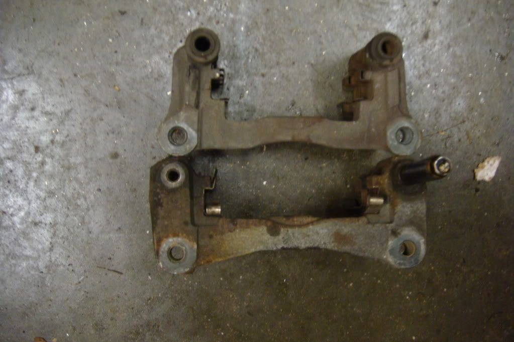

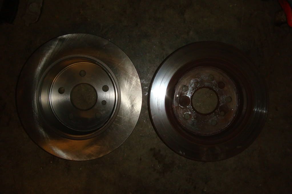

I gotta give Adam all the credit on this one as he is a genious with part #'s and interchangeable parts , so the rear big brake kit turned out awesome. Camera crapped out couldn't get a final pic of everything installed but heres some pics anyway . This is a 2000 Solara V6 using the rear backing plates, brake pads, caliper and caliper brackets from a 1995 Camry V6 wagon. Rotors are 3/4" larger on the wagon, calipers are bigger, and its an OEM easy clean swap! I am going to be putting these kits together to sell by the way :) If you have a 92-99 model year, You already have the larger calipers so you won't need those.
Larger Wagon backing plate on the left.
Wagon caliper bracket on bottom
Larger wagon brake pads on right
larger Wagon calipers on the right
Man my camera sucks, but anyway the larger wagon rotors on the left.
Another shot of the larger Wagon calipers on the bottom.

Holy crap the caliper is much different then I had thought.....

the camry rear caliper looks like the solara stock front.
