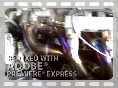

Postby jetbtkng » Wed Apr 29, 2009 8:45 pm
put your knock sensors here thats where mine are, Image Image
Postby ASG14 » Wed Apr 29, 2009 8:46 pm
That are both in the same spot, and you need to take 100% of the SAME parts off to change either.
I'd recommend getting a new Knock Sensor harness at the dealer for about $30 in case the connectors on your current one brakes.
ASG14
Posts: 1632
Postby jstarone » Thu Apr 30, 2009 1:46 pm
Il have to find someone to make me a custom bracket like that...
