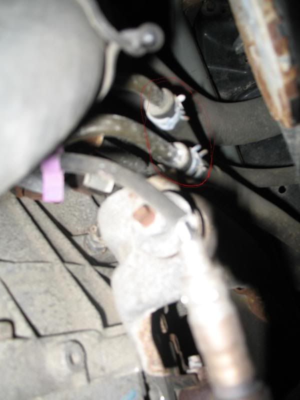

Hello again my friends, been a while since I have been here but I am back seeking an answer to a relativily easy question.
My system works but the cold air slowly stoped being cold, so I went to autozone with my problem and they told me to purchase this freon boost kit with a gauge attached to it. So I did but i'm not positive where I should hook it up too.
I think I should do it here Image
but my dad thinks it should go somewhere here Image
he is a stubborn man so I'm here to prove him wrong (I hope :) )

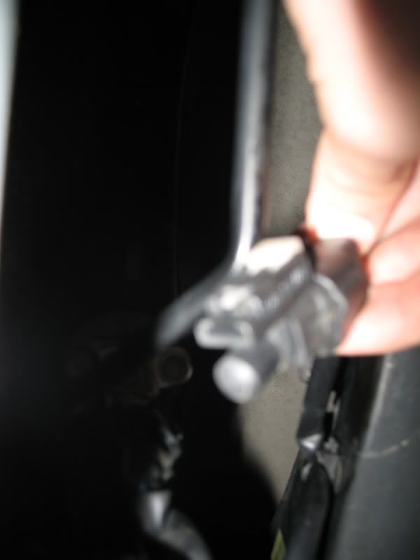

Oh and while I was looking around I noticed this Image just kind of laying there by my first picture. Whats that about...
Autozone is like 20 min away so I didn't want to drive back and ask. Thanks for your help.

Postby TadS » Tue Jun 03, 2008 5:25 pm
I think it needs to go to the low pressure side. Your dad is on the right track, but I think that is the high pressure side of the AC system. It should be in the instructions with the kit.

Postby Eye8Pussies » Tue Jun 03, 2008 8:14 pm
the low pressure side is near the passenger's side firewall...the one that you're looking at is the high pressure side if I remember correctly

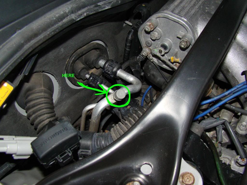

Postby Midias » Thu Jun 05, 2008 5:47 pm
You put the can in that side it may explode put it here
Postby Chinky420 » Thu Jun 05, 2008 6:33 pm
midias wins the cookie
low press by the pass. side, next to intake manifold

Postby stainless » Sat Jun 07, 2008 8:29 am
guys thank you so much! We found it, did it, and it works amazing! I can't beleive I went a year without AC because I thought a proffessional had to do it. Thanks again !!!!
