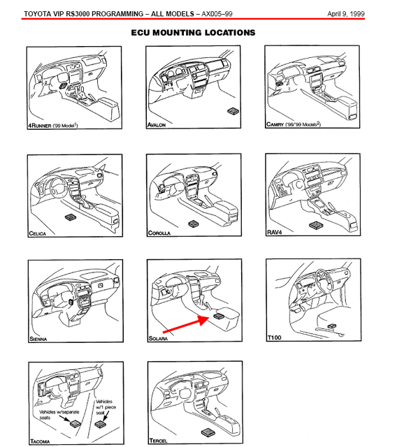

I have the VIP RS3000 factory alarm and my alarm computer (keyless box) is located under the armrest:
