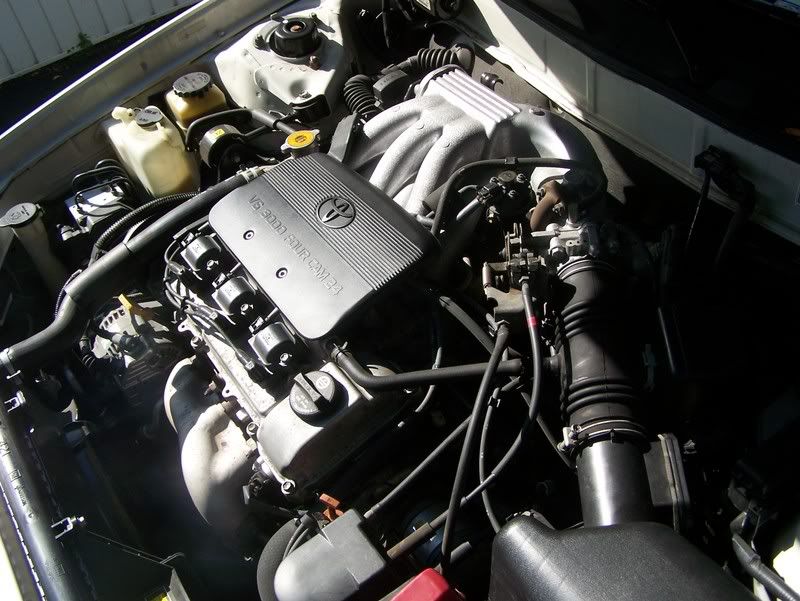

Postby GreeKAvaLoN » Fri Aug 28, 2009 8:56 pm
heres some pics with my engine cover off.
and one more full engine shot
idk about you guys but i think our motors are pretty damn identical. except the headers. they look slightly different i believe.

Postby 99BlackSandv6 » Sun Aug 30, 2009 1:08 am
WTF!!!
That is not what the vacuum lines look like on the intake I bought. They must not be telling me right. I'll see if I can get some pics of the one I have.
Thanks Greek!
