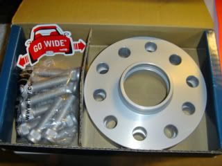

CASTRO wrote:hmm from siennas pics, seems to have the hubcentric lip... can you confirm that?
Danny, do you have any more sets of these, and if so how much + shipping to 95758?
They are the DRS type - 15mm, 60.1 center bore and yes, they have the hubcentric lip.
Here is the package (a pair of spacers and qty=10 - ~60 mm long wheel studs)

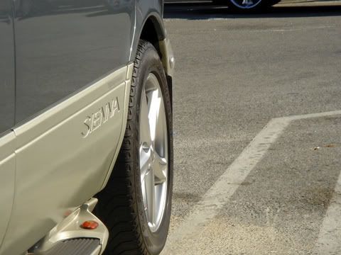

Will install the front spacers tomorrow. I hope that I can now use my set of 18x7.5 Motegi MR-7 Gun metal with 235/50 ZR18 Michelin Pilot Sport tires.
Here is picture of the rear tire and fender clearance now which I think it's just right.
