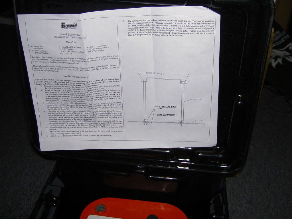

Hi guys,
need help from guys who did a battery relocation or know the wiring to do. First I thought I would have to plug the battery positive on the alternator. I checked again and in stock mode...the battery positive go to the starter and a little wire from the positive go in the fuse box. The ground is screwed near the starter too. I'm just wondering now what to do because the alternator must have a link to the battery...but I don't see it.
What would be the way to route my wire from the trunk to simulate the same thing as stock mode ??? If no one can help me on this...I'll give up the idea....so no cold air extension. :S

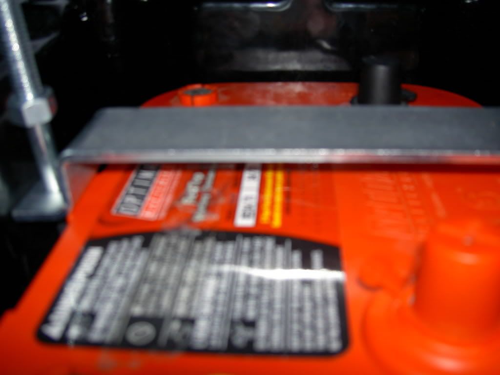

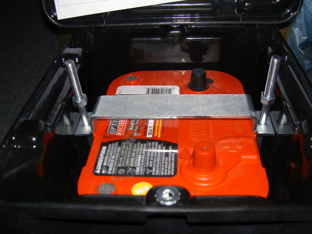

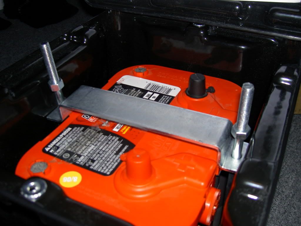

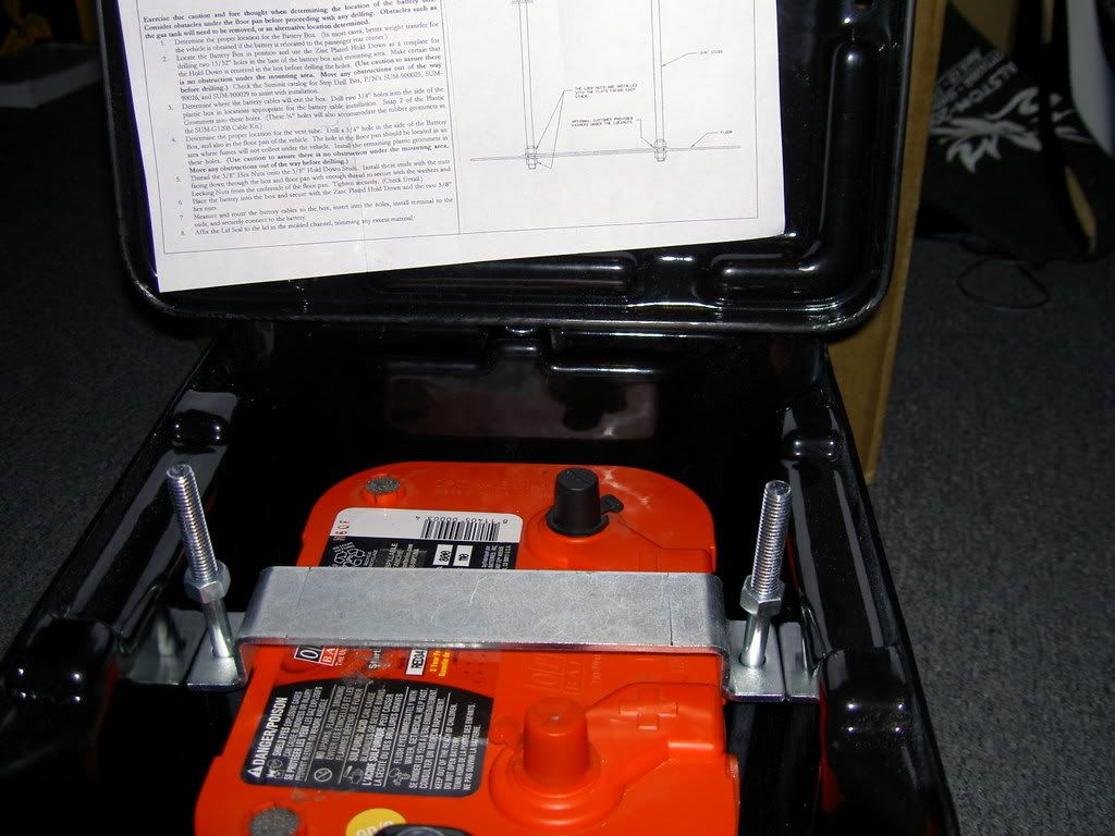

Not the only problem...bought a relocation kit from Summit Racing...the Optima redtop battery (group 34/78 ) ...the hold won bracket is just too short to sit properly !!!! :evil: Would have to put in upside-down and do so customisation with wood or so...to stuck the battery.

Postby Sparky5e » Tue Jul 17, 2007 9:35 pm
Not sure how to get from the trunk to the engine bay. If you figure that out just terminate the ends where the stock locations are. I would probably opt for a ground kit upgrade, saw a link somewhere for it but memory is shot.
As for the battery box I see a few options. First is to have a metal shop bend a new bracket to span the battery. An easier option would be to put some PVC tubes over the long studs to take care of side play. Then use a piece of flat stock across the top to hold it down. You could even weld some tabs to span the battery on the flatstock. Before doing any of that I'd contact Summit, they might have a bracket for the Optima already.

Postby adam8080 » Wed Jul 18, 2007 11:46 am
The best way to do it would be to completely remove the stock positive battery cable and replace it with a longer one going directly to the trunk. The only real tough part about it is routing it, but try to follow other wires to get an idea of where to route it. You can ground the battery on anything solid and metal, just make sure you have a nice clean connection there.
Also the alternator is probably hooked directly to the starter. I don't have a wiring diagram to go by, but several other cars have this same setup.
You can get battery cable and the connectors for the end at any auto parts store. It is always better to get a longer cable and cut it to fit than having to splice two different ones together.

Postby DatSRBoi » Wed Jul 18, 2007 1:44 pm
What I did was I went and brought :
13 feet 0 gauge cable (Might of been longer dont remember)
The cables could be brought at most audio stores. I also brought some new bolts and ends that are identical to to the alternator and for a 10mm bolt to be able to go through. First 13 feet cable I replace the old positive points with that and ran it through the firewall like I do for my subs. I ran the second 13 feet cable as the negative replacing all stock points of the car and ran that to the trunk too (You dont really need this but I did it as over kill to make sure the current is close to the engine as posible). Have those two cable plug into the battery as standard. Now the 3rd cable which is the 3 feet will go on the negative. (so youll have two negative, one from the engine bay and the other negative) The other end of that 3 feet cable will be drilled onto a metal contact firewall somewhere in the trunk.
When you run amp for the subs just do it the same way as if the batter is in the front but instead of running a power wire to the front you just connect it to the back trunk where the battery is now.
As for the bracket being too small you can run out to home depot and they sell bars you can buy about the same lenth but flat all the way. then you can get cushion blocks and put them on each side as you tighten them down to keep them from moving.
Hope that helps.

Positive actually splits into 2: First one is actually the starter, then the second one one goes through a 100A relay first, which the relay branches off into about 10 more sections before reaching the alternator (but note one of them DOES connect directly to the alternator after the relay).
Postby Sebas007 » Thu Jul 19, 2007 5:21 am
Thanks guys...I'll use a mix of many way of your solution.
For the bracket I'll make it sit upside down and use some cutted PVC to stuck the battery on left-right way, front-rear way and the barcket will do it for up-down way. Cut those 4 curvy 0.5" deep bow (the egg's strenght shape) in some PVC piping.
http://www.rbeelectronics.com/wtable.htm
Using this gauge size vs lenght table
I'll run a 2 gauge size wire for positive to the stock positive wire that is already connected to starter.
I'll connect a 2 gauge negative to the frame.
Postby Sebas007 » Sat Jul 21, 2007 4:28 pm

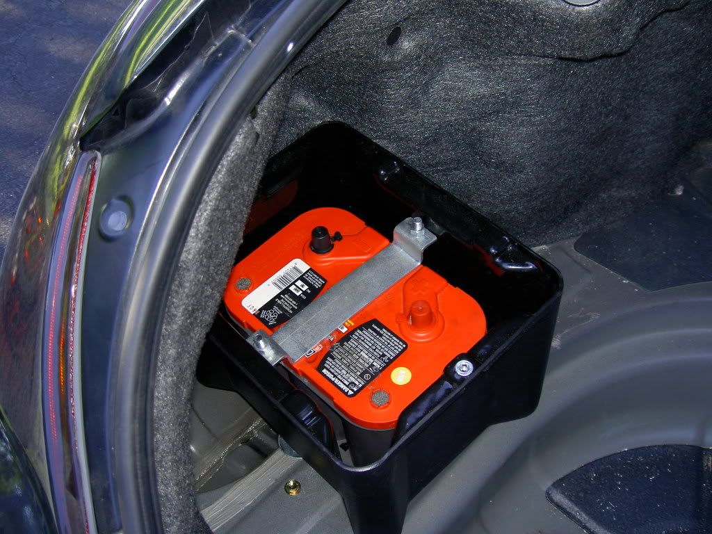

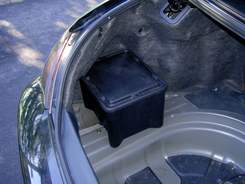

Phase #1
Pass thru the existing hole
Open up the rear driver side panel
It is pretty solid. Doesn't move at all.
Still to do...
Need to put back the carpet (was to hurry to think about it :evil: )
Need to drill the firewall
Need to screw my kill switch
And some connections...
