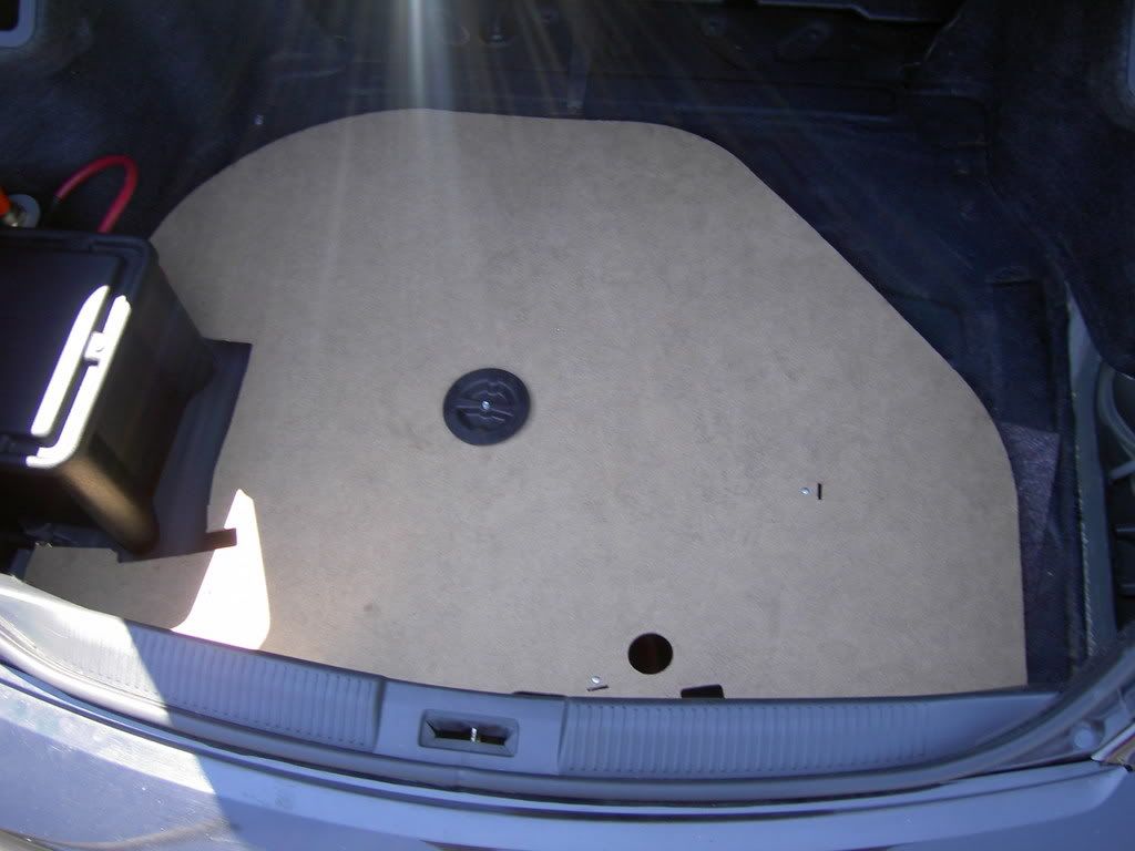

Postby Sebas007 » Mon Jul 23, 2007 7:46 pm
tie-wrap fest. Don't worry I trimmed them before finishing anything !
Routing under the kick panel
Thru the firewall (inside the car)
Trunk floor cutted
The floor carpet cutted
Thru the firewall in the engine bay. (The grommet was a bit pain in the ass to put !!). Had to buy a 3/4" drill steel bit to make the hole.
Look "clean" inside. (I know it is a bit dusty ! ) ;)
Finally made my connection on the stock bolt on the stock positive terminal
View #1 (Engine bay)
View #2 (Engine bay)
Switch turn ON !!!!
Car in fire !! :P j/k
Finishing my connection, I saw that my CP-e pipe had 1 little hose loose. I put it back and I really feel a difference in power...don't know if the filter gets colder air or if the CP-e now acts like it suppose to do...anyway :)
