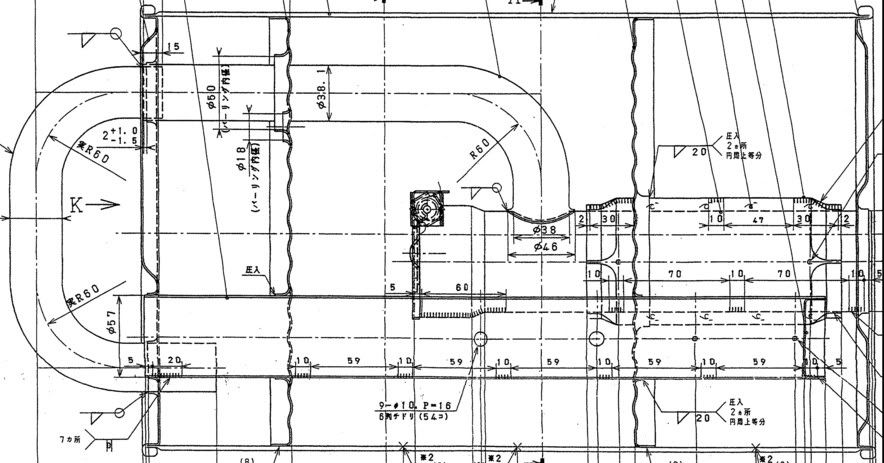

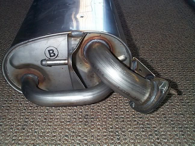

The OE Muffler design is pretty good at doing its job. It's VERY difficult to balance backpressure and sound pressure levels. Here's a few snap shots of the OE muffler and a drawing of the internals. (I've got a photo of the internals cut open, but not with me today.
There's no doubt that there are cheaper ways to make this part. However, Toyota is pretty strict on the acoustic quality. If they were not, your Solara might sound like a Hyundai. (Yuck!)
