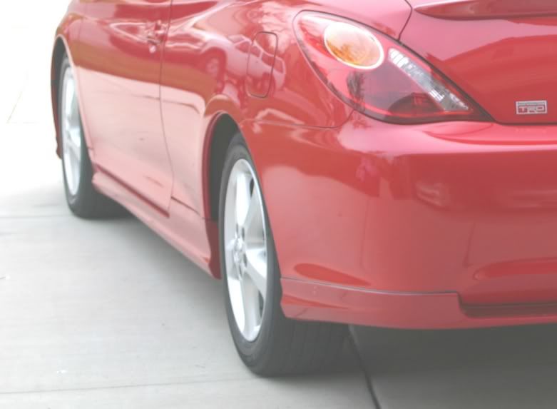

Here are the pics: Before and After
Before: OE Toyo 215/55R17
After: Firestone Firehawk LH 235/50R17

Postby PhreakdOut » Sun Jun 26, 2005 12:43 pm
cabacholoco wrote:I just replaced the stock Bridgestone Turanzas with 245/45/17 Toyo Proxes T1R's last week. Like driving a slot car now. Tires are nosier and stiffer, but they definitely are much stickier than the crap Bridgestones the car came with new.
Sweet. I'd love to see pics.
Ahem...

Postby PhreakdOut » Sun Jul 24, 2005 3:56 pm
mmcdonald wrote:You will need aftermarket wheels for a start.
See pictures above. The 235's are on OE wheels with no fit or clearance problems.
Postby mmcdonald » Thu Jul 28, 2005 8:24 am
Well I'll be dad-burned! They do fit.
