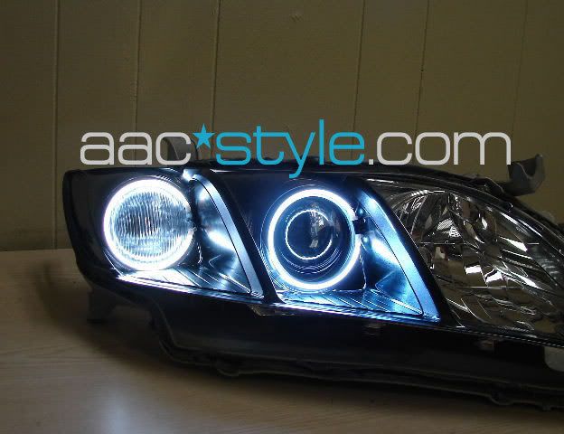

What would you guys think about angel eyes on the projector?
I am starting to think they look to "ricey" or just too cheapo. Not sure. I would love some opinions.
Camry:
Supra:
from:
http://www.toyotanation.com/forum/t204166.html
Last edited by philosophicaljt on Tue Aug 07, 2007 8:35 am, edited 1 time in total.
