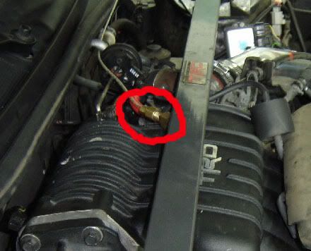

I'm running a SC, 4psi, 305cc injectors, 190 walbro, manual, greedy evo 2 catback, jims fuel upgrade, k&n air filter, AFC neo, EBC...
I've noticed two things:
1.
The red circle, that tube isn't hooked up to anything. It is blocked off with a screw in a rubber tube on the metal male connector.
Should that be hooked up to anything. If so, should it be a hard line or a rubber line?
2. When the gas tank is full, I can only push the accelerator down 20%(AFC neo tells me) before she starts to spudder.
When the tank is 1/3 full, I can press the accelerator down 35% before she spudders. Also as the rpm's go up(when accelerating) I can push the accelerator down further untill I have to shift.

1. that line is the tap ur boost gauge uses to read the current vac / boost pressure. Its a silicone hose (thin) and if u dont have a boost gauge then leave it tapped with a stopper.
2. ur FPR is not adjustable in any "true" sense. U could crush it to allow a higher psi but i wouldnt recommend it....cause u dono what its at till u have a read out, and the fpr is in the fuel tank in the fuel pump assembly. Did u get a tune with the new injectors? hopefully u did and didnt go into boost with out a tune with those injectors in yet.
