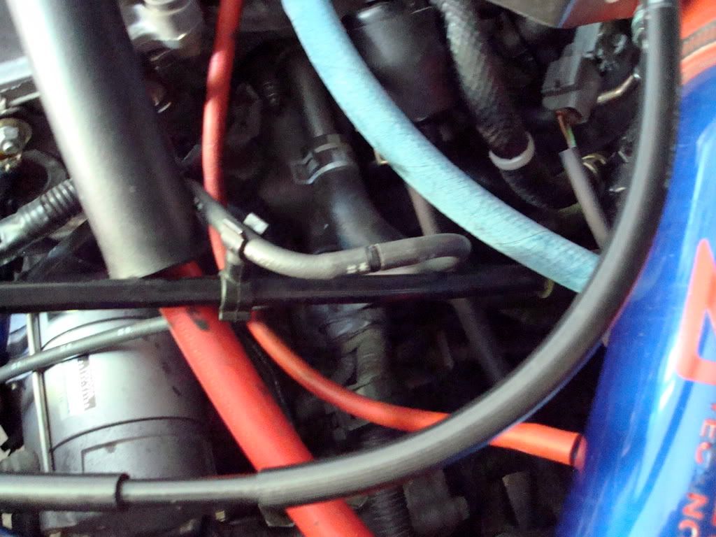

So i went to the toyota dealership and had a talk with the mechanic there, he said the way my hoses were fitted is limiting my boost. But from what i understand, the way i have my hoses setup is for the "boost on demand" mod that i think Vampire created...check it out. Anyone else have this mod?
The mods can be clearly seen, they are the silver + red hoses.

Postby CASTRO » Mon Jun 11, 2007 2:39 pm
thats a whole lotta hoses from when i had mine setup to bypass the actuator controller. look over some old posts that included me and vampire over the hosing setup debate.

Postby Eye8Pussies » Mon Jun 11, 2007 3:56 pm
I'm still not sure about that boost-on-demand thing....I tried it, and it kind of felt like boost came on faster, but it also made my car run super lean.....so I had to switch back to my original setup.
I'm not sure if it would do the same to your cars though.

Dawgz wrote:So i went to the toyota dealership and had a talk with the mechanic there, he said the way my hoses were fitted is limiting my boost. But from what i understand, the way i have my hoses setup is for the "boost on demand" mod that i think Vampire created...check it out. Anyone else have this mod?
Mine is setup differently. I just have it run like the original setup, not the way it says in the supplemental. I've got the boost actuator going straight to the underside barb. I looped the in/out of vacuum tank together. The other 3 under the engine cover are capped off.

Postby Astro » Tue Jun 12, 2007 10:10 am
Here's the routing of the hoses. This follows the original setup w/o the EBC (electronic boost controller).
This is under the valve cover. I only had 2 caps, so the last one I just used a hose and capped that off.
This is the actuator and barb on the underside of s/c.
Here's the looped vacuum tank hose.
