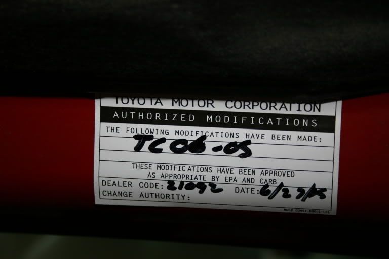

Postby dvdchris45 » Sun Aug 07, 2005 4:56 pm
Look near your door sill area where the tire size/pressure sticker is. There should be a sticker there I'm guessing. They put one on mine after they reflashed it.

Postby PhreakdOut » Sun Aug 07, 2005 5:11 pm
They put mine under the hood. (Near the cowl) Kind of an odd place
Postby cklinh » Sun Aug 07, 2005 6:01 pm
Does everyone that had the TSB applied have that same sticker? If so... I think it's about time I go to a different dealership...
I'm even more convinced that they either:
1) Didn't flash my ECU at all, or
2) Screwed up while doing it...
My mileage has been horrible after going to the dealership... and I'm still lagging like crazy.

Postby cklinh » Mon Aug 08, 2005 3:01 pm
So... I've finally gotten around to READING the TSB... and part of the directions are to affix that sticker in a specific location. I will be going home to check on this tonight, and if that sticker is not at that exact location, I am causing HELL at the dealership.

Postby cklinh » Wed Aug 10, 2005 4:09 pm
Anyone that has had the TSB applied, your help would be greatly appreciated. Do you all have the sticker under the hood? I called the service guy at my dealership and mentioned that the TSB required that sticker to be put on after the reprogramming. He's trying to tell me he doesn't know anything about applying a sticker after a TSB. I just want to get the facts/statistics straight before I confront him on Friday.
EDIT:
Checked with the Master Technician at the dealership. The TSB was done on my car (he showed me the softwar eversion, they just ran out of stickers. I still have the lag though. He stated (his words) that Toyota is DEFINITELY working on another fix since this one didn't cure every car.

Postby online » Fri Aug 19, 2005 8:47 am
Just picked my car up from the dealership. They flashed the ECM based on TC006-05. Only one word to describe it OUTSTANDING!!! Lag is absolutely and completely gone. I tested from stand still through various accelerartion conditions and mph points.
When I scheduled they didn't question me just noted the problem description. When I dropped it off the service tech made mention that he thought it was applicable to certain VINs. I told them it was appicable to all 3.3 2004, 2005. No questions were asked.
fyi...mine is a 2005 that I picked up in August 04. The entire process took just over a hour
