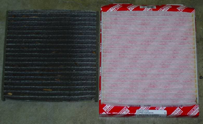

Postby jsie » Thu Dec 22, 2005 10:48 pm
I just changed again for the second time (30k maintenance); and, here's what it's looked at 15k vs brand new one.
Yap. Enough said.

Postby michaels artic frost » Fri Dec 23, 2005 6:26 am
^^Woa!! :o :o That's worst than mine when I replaced it at 20K.^^
