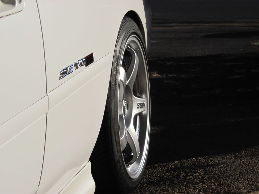

Postby 808lara » Mon Apr 25, 2011 2:01 pm
running 18x9,+31 offset ssr gt2's on my rears. have trd springs, tokico blues with fenders rolled-no problems with rubbing. running 18x8.5.+48 on fronts. tires are 225-40 front, 235-40 on rears. don't see why they wouldn't fit on fronts.

Postby MCX20-XLS » Sun May 22, 2011 3:02 am
808lara wrote:running 18x9,+31 offset ssr gt2's on my rears. have trd springs, tokico blues with fenders rolled-no problems with rubbing. running 18x8.5.+48 on fronts. tires are 225-40 front, 235-40 on rears. don't see why they wouldn't fit on fronts.
Any way you can get a picture of the inner clearance ?
My Avalon has the exact suspension & fitment problems. I tried to run a 17x9 +35 Desmond Wise Sport with a 215/50/17 Kumho ASX and found out the hard way that I will need at least a 3 mm spacer to clear the rear. Its crazy how much more inner clearance there is on the front when compared to the back.

Postby 808lara » Sun May 22, 2011 10:39 pm
Image pic of outside-none from inside-but checked and there's about 1/4" clearance between the strut and inner rim lip.and yes, the front has way more clearance than the rear.
