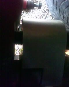

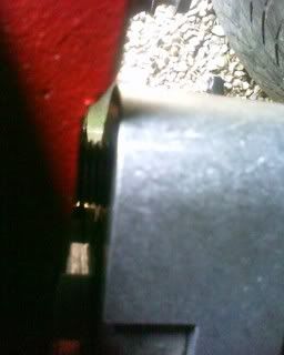

Another shot of the gap. If I tighten it anymore it pulls on the rotor.
A shot of it without the rotor. Does it look crooked to you???

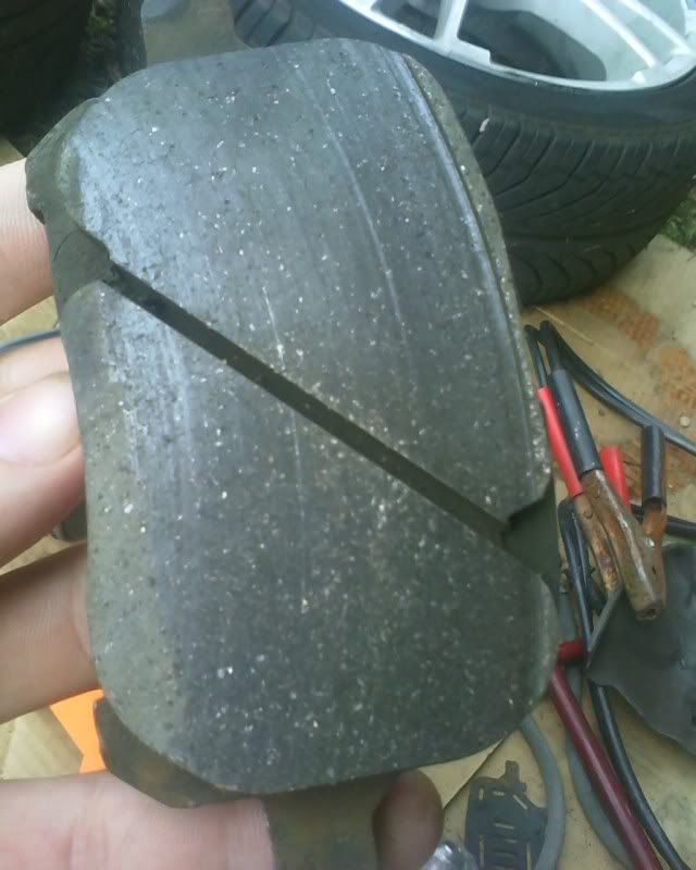

Here is a pic of the old pad. Look at the right side. It seems that Ive been getting uneven pad wear.
Another shot of the same pad. This is the only pad that looks like this. It came from the outter driver side OEM brake bracket.
Ive gone through every possiblility of what could be the problem. Like I said before the passenger side mounted up with no problem at all. Also when I try to put everything back to OEM, it doesnt go back on correct. I have the same problem that Im having with the BBK kit. It doesnt want to line back up correctly. How could the OEM brake bracket mounting points be off. That piece is solid steel.
