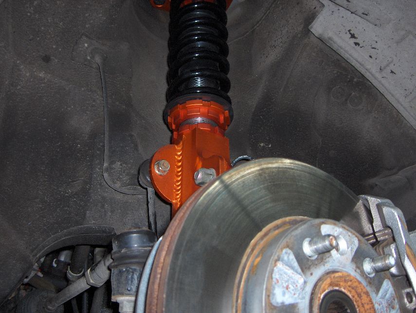

Postby akora12 » Mon May 25, 2009 5:12 pm
The newer model c/o's from ksport have a "floating" sway bar mount on the shock body in which you can adjust the preload on the sway bar. The mounts can be bought separately from ksport and may easily solve your problem.
Postby supamouse09 » Mon May 25, 2009 10:18 pm
thanks alot akora that is the exact picture that i needed so the shop can order the parts. if u dont mind me asking how much did u get them for because i need a set for the front and the rears.
