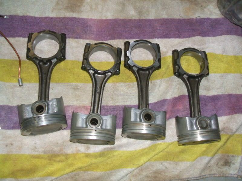

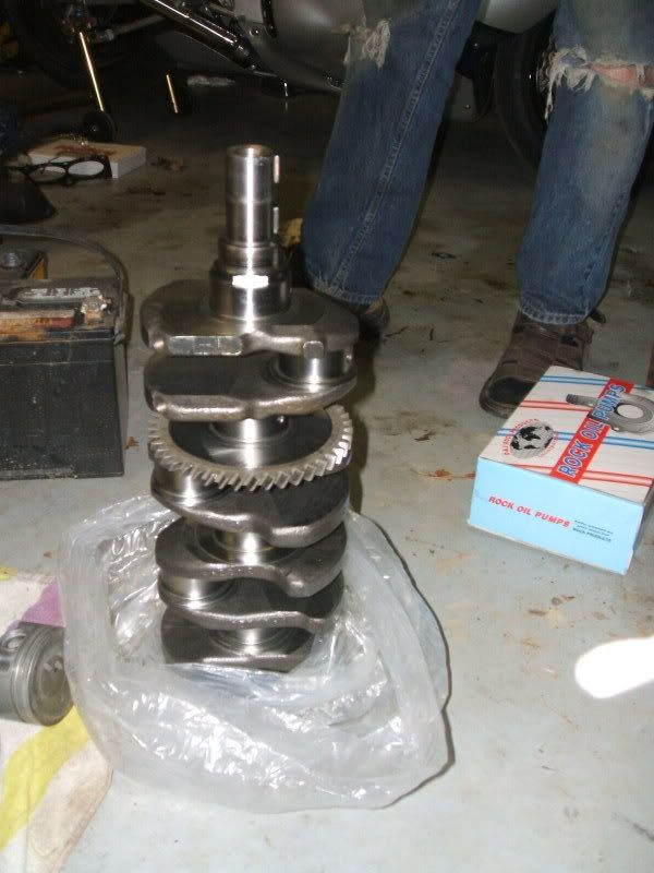

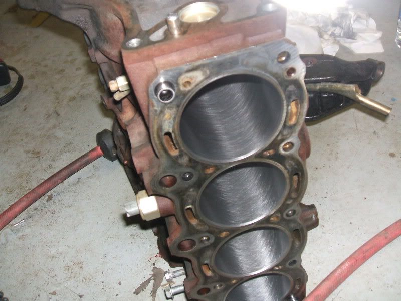

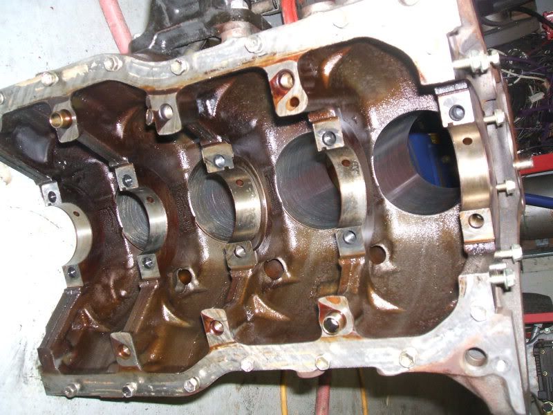

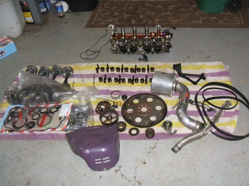

Postby Fastlane051 » Sat Apr 04, 2009 12:08 pm
Well dang it - i already bought a new oil pump from when piston 1 screwed up and threw metal all in my oil!
My crank was ground 10 thousandths at the mains and 20 at the rods and Im pretty sure all my internals are forged
I have pictures if that would help?

Postby gnegroni » Sat Apr 04, 2009 2:41 pm
He has the 2AZ-FE if I'm not mistaken, not the 1MZ. I know the rods could be forged but hold up pretty good, the crank is forged, but I don't think the pistons are. If you plan on supercharging or turbo, you should buy forged low compression pistons (8.5:1 or 9:1). If your not, then you should purchase forged high compression pistons (11.0:1) which also accept nitrous.
sydemoid's advice fits except for the Jim's fuel mod (only applies to the 1MZ).
