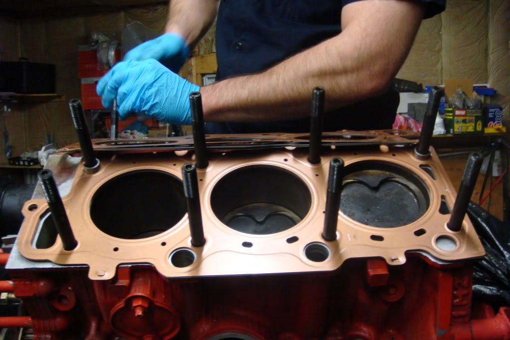

Postby trd4life » Tue Mar 31, 2009 5:55 pm
Wanted to show you a build i just finished up for a customer. 1mz-fe block bored 20 over with arias forged pistons and modified eagle 22r forged rods. ARP head studs and copper coated MLS gaskets! The built block was in my red knight solara for 10,000 miles. The block will handle whatever you thorw at it thats for sure.

Postby Mr_Chunkz » Tue Mar 31, 2009 6:52 pm
the red is a tad garish
no offense gabe
This engine is puttin out 9.0:1 compression ratio too, right?

Postby trd4life » Tue Mar 31, 2009 6:58 pm

Postby Eye8Pussies » Tue Mar 31, 2009 7:40 pm
looks sexy....but it's going to need a decent bit more boost to make up for the 1.5 point drop in compression ratio.
good thing for the increase in displacement :drinking:
Postby Mr_Chunkz » Tue Mar 31, 2009 7:51 pm
what do you guys predict this engine would make on 8 pounds of boost?

Postby Eye8Pussies » Tue Mar 31, 2009 8:19 pm
presuming you run a 10psi pulley to actually make the 8psi of boost? probably 300whp on a 5-speed I'd say. too much hot air at that time I'd say to get much more even with meth.
So, not that much more than say, a stock 1mz on 8psi, BUT it will be able to hold up to it steadily and reliably for years since it was built to handle it, and hot air won't be as much of an issue.
But I'd say that a built 1mz with a blower is a waste of money and effort. A turbo setup without all the weaknesses and limitations of the blower would be a much better use of the motor.
The only exception to that opinion I would say is though is that built block on 8psi with the blower and a 100-150 shot of NOS....then it's worth the build ;)
