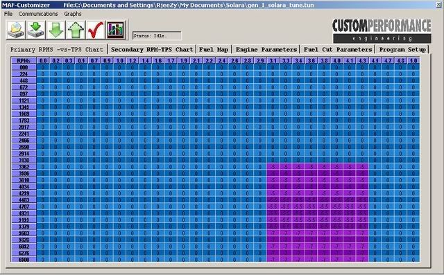

I'm planning on running my cp-e intake without the blackbox and using a SAFC2 instead. My problem is figuring out the low throttle values so that the MAF sensor is happy in the larger 3.5" piping. I'm not sure how the tuneable blackbox works, but for those of you that have it...
Could someone check to see what the pre-set values are? I don't even know if these values are displayed in the cp-e program, but if I can duplicate that on my SAFC2 I might just be able to re-install my intake.

You should be able to run the program on your laptop and load up the map that's on the CD and see the value.
I the low values are -5.
Postby akora12 » Tue Aug 12, 2008 8:45 am
SleeperSolara wrote:You should be able to run the program on your laptop and load up the map that's on the CD and see the value.
I don't have the tuneable version, so I can't see any of the values on a laptop. I basically just need the correction values for each interval of rpm. Is it -5 accross the board?

Postby 99V6solaraSE » Wed Aug 13, 2008 11:30 am
i have the tunable.
i have it somewhere on my laptop.. im on lunch now. I might be able to get it to you later.
here u go.. does this help?

Postby akora12 » Wed Aug 13, 2008 1:17 pm
That's exactly what I was looking for. Just to confirm, this is the base map before your tune?
This goes into quite a bit more detail than the SAFC2, so I hope I'll be able to reproduce this.
Postby 99V6solaraSE » Wed Aug 13, 2008 3:35 pm
yea thats the base tune.. and ur right it goes more in depth than the safc. it has more tuning points than the safc. thats why i decided to go with the tunable.
