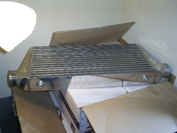

30x24x4 intercooler. damn tight fit!

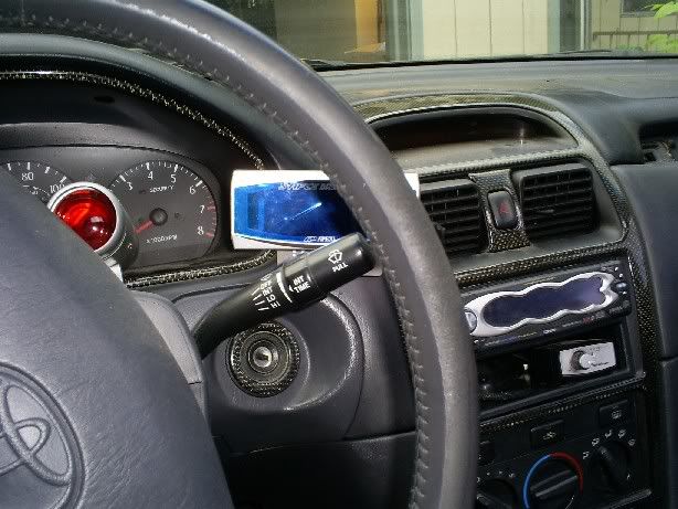

SAFC II for tunin

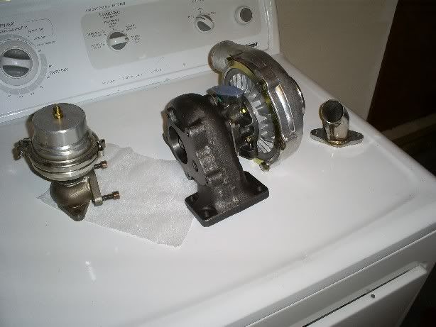

turbo and regulator. its the biggest t3/t4 hybrid before t4's.
