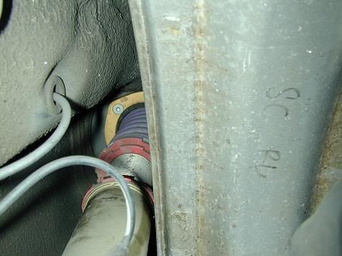

Postby tweazy » Thu Mar 27, 2008 11:51 pm
My rims have been installed. It turns out to be a bit tricky in fitting these rims.
Like the previous owner of my rims, I ended up using 2 spacers in the rear. a 5mm and a 5/16" spacer for each of the rear wheels. I also used a 5mm spacer for the 2 fronts.
Here is a pic of how close the rims are to the coilovers (rear wheels). You definately will need to roll the rear fenders.

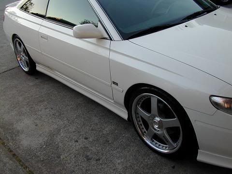

Postby CamryOnBronze » Fri Mar 28, 2008 1:59 pm
youre going to want a +35 offset in the rear with an 8.5" wide wheel, that is pretty much perfect. It gives you a few mm of clearance over the coils and comes pretty flush with the fenders.
I am running 18x8.5 +40 offset wheels with 225/40/18 tires and a 5mm spacer out back, and everything is perfect IMO. We had to roll the fenders because of my drop, and after that it all cmae together perfectly. I have a slight rub up front and would probably rub in the rear if I had passengers, but I never do so it doesnt matter anyway.
Here is a shot of my setup to give you an idea of where everything sits:
