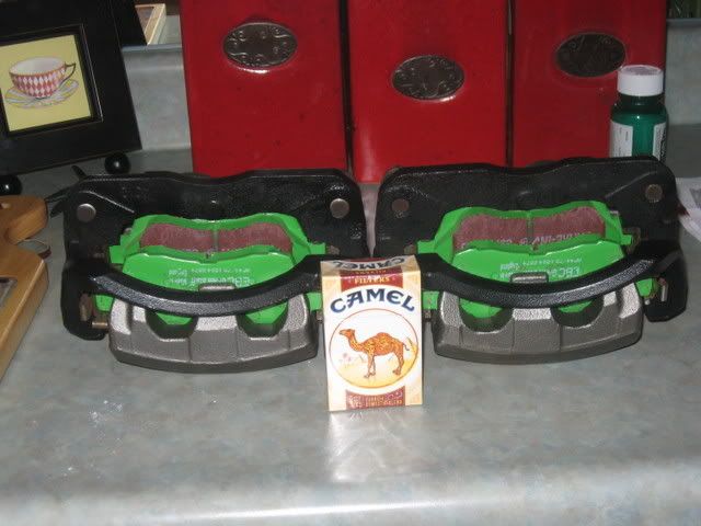

Postby Jakecallun20 » Wed Feb 11, 2009 8:23 pm
Alright, next update on my project. Got my pads in today!! EBC Green stuff pads!! Can't wait to get these buggers installed. Should be goin down this weekend! I tell ya, these caliper pieces are big, I set my pack of camels next to them to show you the size of these guys.
Postby SleeperSolara » Wed Feb 11, 2009 9:18 pm
Bad arse man.
Can't wait to see the final pictures and final thoughts on it.
8)

Postby Jakecallun20 » Thu Feb 12, 2009 11:29 am
Oh gawd. I never even thought about these calipers not fitting inside my wheels. I'm running the stockies, 16" I think....6 spoke SLE wheels with the black and silver center caps....ugh. I hope it fits. As for rotors i'll be using the stockies.
Postby Gibson99 » Thu Feb 12, 2009 12:20 pm
Jakecallun20 wrote:Oh gawd. I never even thought about these calipers not fitting inside my wheels. I'm running the stockies, 16" I think....6 spoke SLE wheels with the black and silver center caps....ugh. I hope it fits. As for rotors i'll be using the stockies.
You'll be fine inside 16" wheels. It's the people like me with 15s that might need to worry.
That said, the gen3 camry (and gen1 avalon for that matter) never had a 16" wheel option so they should even fit inside a 15" wheel. :up:

Postby ASG14 » Thu Feb 12, 2009 1:01 pm
They will fit any 15". Not 14" though.
