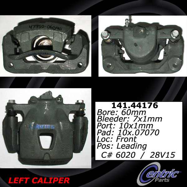

Postby alltrac92 » Fri Aug 21, 2009 5:46 pm
They have a kit for the Toyota matrix 6 piston. While I'm sure the rotor hat is wrong for our cars the Matrix is 5 x 100
That caliper bracket sure does look interesting.

Postby alltrac92 » Sat Aug 22, 2009 11:27 am
06-07 WRX
06 350Z
04 Matrix
2000 Camry/Solara
1994 ES300
alltrac92
Posts: 409
Location: Citrus Heights, CA

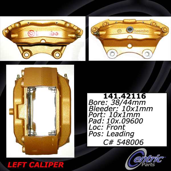

Postby JvR » Sun Aug 23, 2009 2:56 am
In the Netherlands, were i live, there are no Lexus es300.
So i hope to find a other replacement that fits to.
Will a land cruiser caliper fit? (http://www.schadeautos.nl/auto.php?id=335233)
It looks it has also a 2 cylinder setup.

Postby alltrac92 » Sun Aug 23, 2009 3:19 am
1992 Landcruiser

Postby JvR » Sun Aug 23, 2009 12:41 pm
They look very pretty , but i don't understand the numbers??
So this is a no?
I have got the Ericsol relocate brackets.
