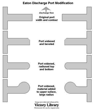

Postby panic » Wed Aug 27, 2008 9:59 am
I was afraid you were going to say that :D
If anything, the compressor discharge area is too big, and much money (and cases) have been destroyed attempting to "improve efficiency".
There are some changes to the exit side that are helpful, but they're fairly complex (not intuitive at all).

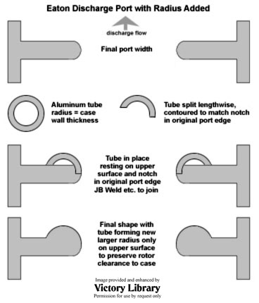

Here's an example of things that work:
and how to do it, but annoying (needs work from inside):

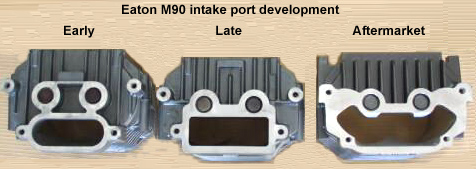

Enlarging the intake side is equally dangerous, since the amount of the actual inner port exposed to the TB duct is a function of rotor timing, very delicate. A straight enlargement of what appears to be the critical surfaces is a mistake.

Postby panic » Wed Aug 27, 2008 10:35 am
M90 intake ports over 20 years
Notice how the floor remained constant, and the last stage moves the port outward only at the upper edges - this exposes more inter-lobe area.
