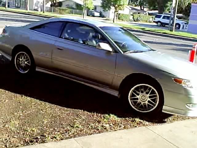

^ That's the same setup my Solara came with when I got it. It was super smooth, not harsh at all IMO. Here is a pic of what the drop looked like:

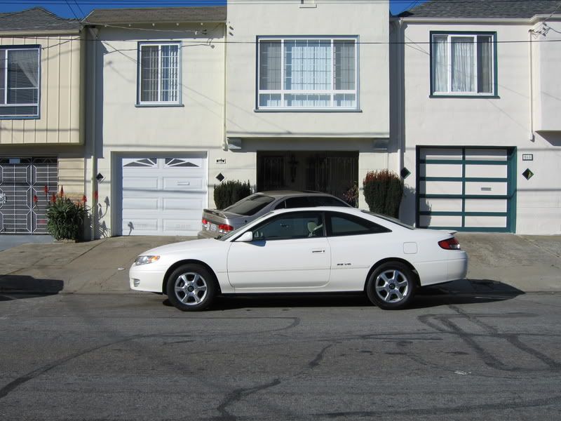

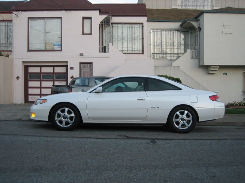

here is mine on stechs teins and stock struts. I had about 70k on the struts so i thought it would be fine. It lasted a while but changed them out to gr2s around 105k.
No money and i did my own installs so it wasnt a problem for me.
Stock-
Teins-

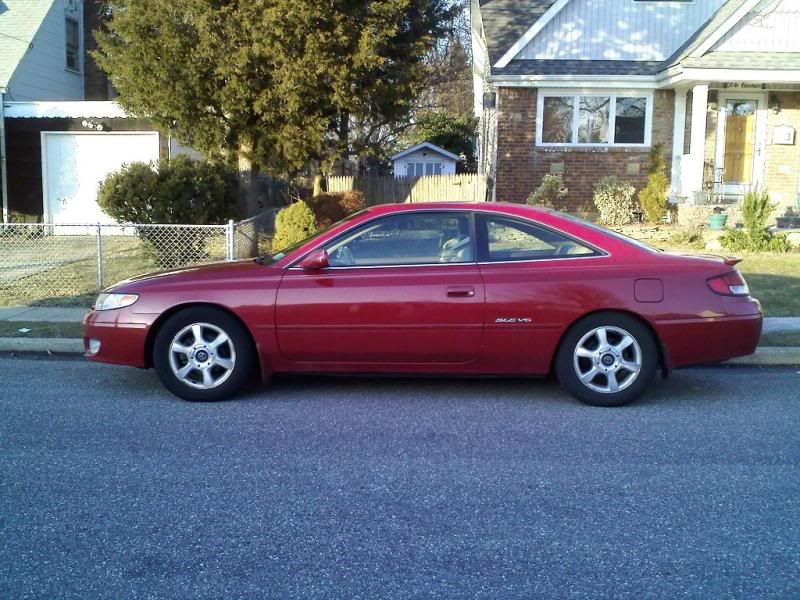

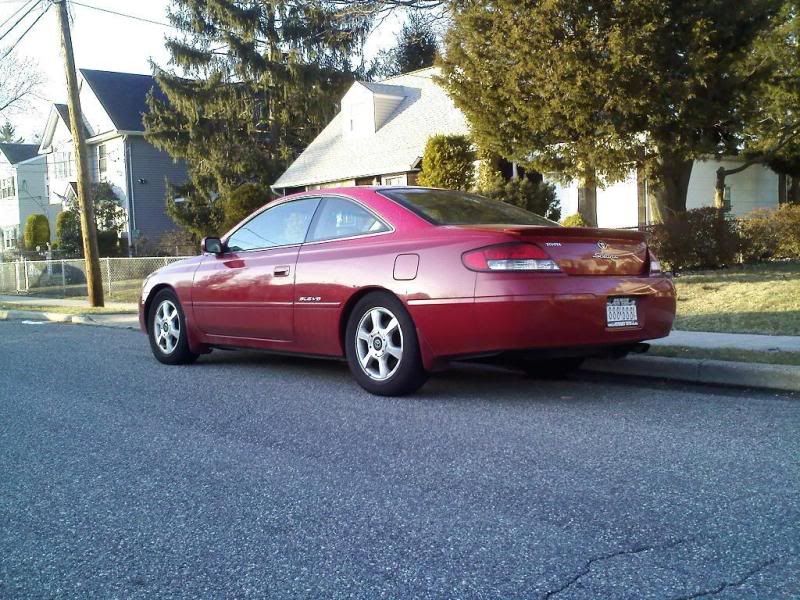

Here's a few pics after I installed them over the weekend.
1st Gen Sol
Stock Sleeper
Stock Sleeper
