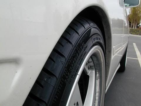

Postby tweazy » Sat Mar 29, 2008 1:44 pm
+38 offset is fine for the front.
I placed a 5mm spacer in my front wheels only to match how much my wheels stick out in the rear.
Front wheel 19"x8.5" +38 Offset with a 5mm spacer
Rear Wheel 19"x8.5" +38 Offset with a 5mm spacer and another 5/16" spacer
Here is a pic of how close the rear wheels are to the struts. This is with the 2 spacers I mentioned above.

Postby CamryOnBronze » Sat Mar 29, 2008 2:56 pm
^ thanks for the confirmation man, Im just going on what ive done personally- good advice :)
EDIT: So if you have +38 up front with a 5mm spacer, then you actually are running +33 up front correct? I didnt know such a low offset would fit up there, good info.
