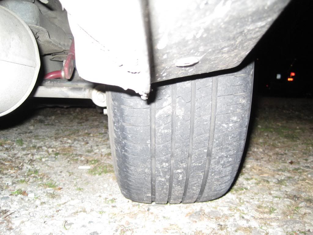

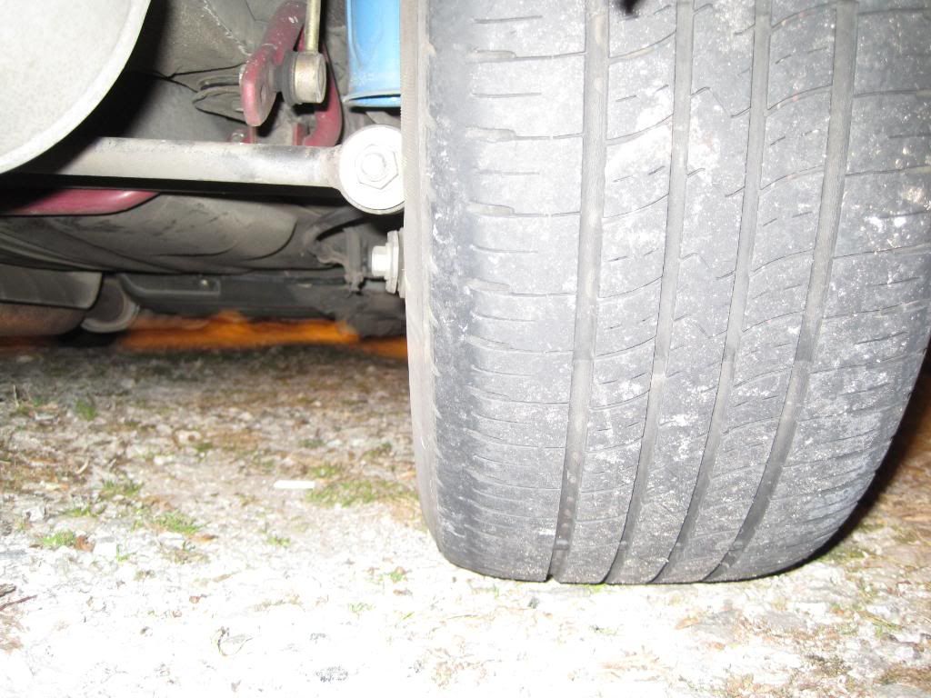

Postby black99 » Sun Jan 10, 2010 10:11 pm
Sorry guys, just went outside and snapped some pics. I apologize for my stupidity but Im running a 205/65/15... My bad. Heres some pics to show whats goin on.

Postby ToyoSolV6 » Sun Jan 10, 2010 10:32 pm
lol yeah i thought a 265 was way too big.
so where is this rubbing exactly coming from?
Postby 99BlackSandv6 » Sun Jan 10, 2010 11:06 pm
Dude, we thought you were running 265/??/15. You are
running a 205/65/15 I'm pretty sure that's the factory size.
So yeah, where is the rubbing?
Postby ASG14 » Sun Jan 10, 2010 11:46 pm
If he is rubbing, there is some badly bent suspension parts.
ASG14
Posts: 1632
Postby ToyoSolV6 » Sun Jan 10, 2010 11:54 pm
thats what im thinking because there is no way in hell that a tire that small is going to rub even if he's lowered.
Postby CamryOnBronze » Mon Jan 11, 2010 7:54 am
The wheel looks to be a lot more flush with the fender than the stock wheels usually are- are you running spacers? If it is rubbing the fender lip, just give it a roll and you should be all set. If that is in fact where it is rubbing, I would do that way before I would buy a camber kit, assuming your camber is withing factory specs. That's my two cents...
