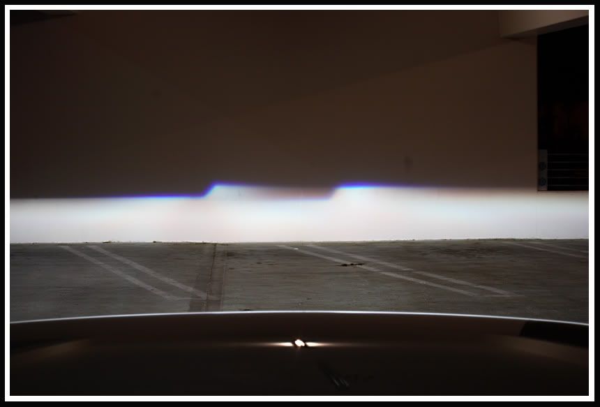

Postby Webb26 » Wed Feb 27, 2008 12:23 pm
Not sure if this matters, but the op didn't really say if he had the projector headlights or not.
1. This output from my camry is a bit off but you get the jist( the driver side connection to the bulb was off so it made that arc look).
2. Here is the spread shot with no black spots...
It only leads me to believe there might be something wrong with the projector bowl, or he is running a reflector headlight.

well for example notice the first TSX picture, mine is sort of like that but on the left side of the beam there are dark spots. I noticed theres a little thing in the headlight that sits right in front of the bulb, I assume thats to reflect it to the reflectors, but that is a little crooked. Should I just open my headlight and sort it out? Or maybe just get new headlights? That s2000 projector is nasty, it would look better on a nicer car though, eew civic.

Postby Webb26 » Wed Feb 27, 2008 3:00 pm
ptballer wrote:^which projectors are you using?
I'm using AP1 S2k...again the cut off is really skewed in those pictures. That was when i first did the retro and things were not adjusted correctly.
Webb26
Posts: 44
Joined: Tue Feb 26, 2008 6:18 pm
Postby Webb26 » Wed Feb 27, 2008 3:06 pm
chrom3titan wrote:well for example notice the first TSX picture, mine is sort of like that but on the left side of the beam there are dark spots. I noticed theres a little thing in the headlight that sits right in front of the bulb, I assume thats to reflect it to the reflectors, but that is a little crooked. Should I just open my headlight and sort it out? Or maybe just get new headlights? That s2000 projector is nasty, it would look better on a nicer car though, eew civic.
The cut off on that civic looks kind of high if you ask me and only is brighter than mine because of the over exposure on the camera. From what you said i am still a bit confused...you said there was something sitting in front of the bulb but still has a reflector? All low beam projectors have something sitting in front of the bulb, and they are shields to produce either the DOT or ECE cut-off. The only reflector in a projector is the bowl itself and can not be seen unless taken apart. You stated you had a reflector...so i'm guessing you are using a HID kit with a rebased bulb, right? Ive heard of some people bending the shield you speak of in order to achieve a safer dispersion of light.
